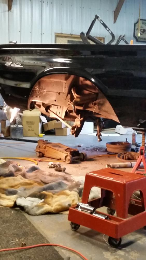

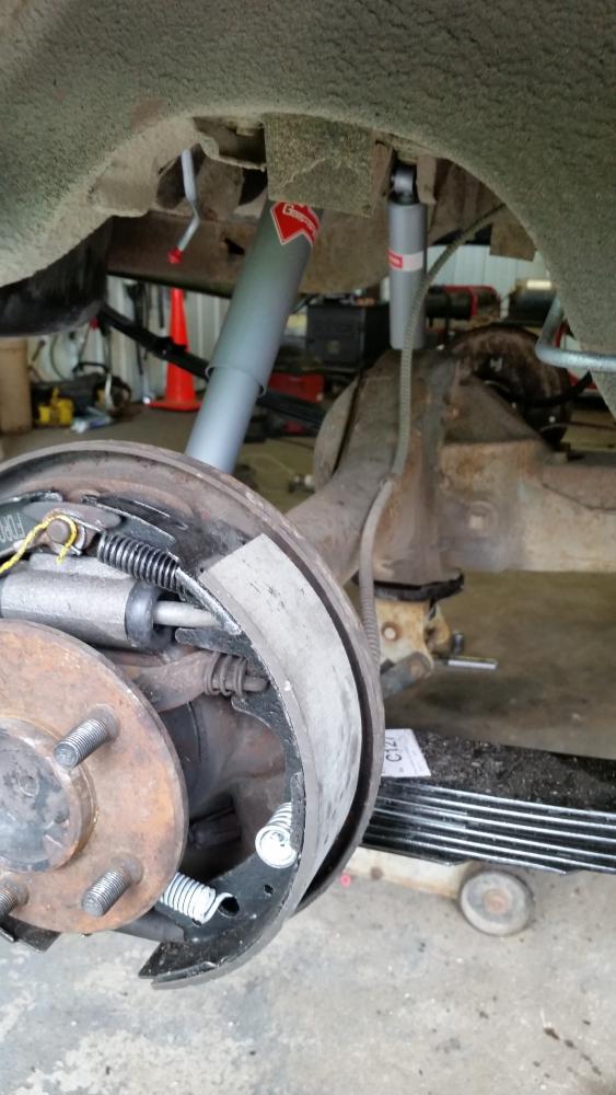

Well where to begin.. First thing was a day consisting of the air compressor and the vacuum and alllllllll that sand/media, just kept coming and coming. First real thing I did was pulled off the old leafs springs and put on a new set of the SS springs, surprised myself and got it all back together in no time. Put on a set of KYB gas-a-just shocks. Confidence grows. Then I started working on brakes. Did the back drums with fresh everything, it went accordingly.

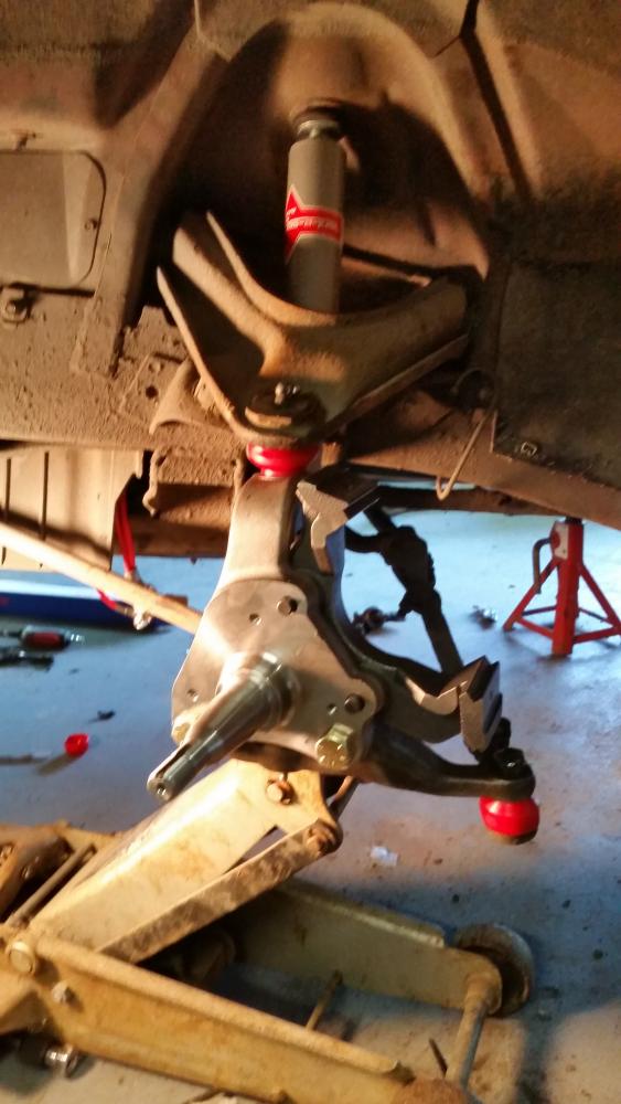

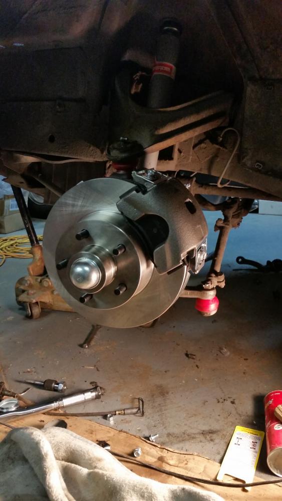

The fronts were a different story. I did a right stuff conversion kit for front manual discs. So I got acquainted with ball joints, found my dads old pickle fork and it all went pretty smooth. Cant say my brake lines were the prettiest but I figure there’s a learning curve. The left side looked much better. …..but those nuts under the dash to change the master cylinder, now those were a real treat. Really enjoyed those.

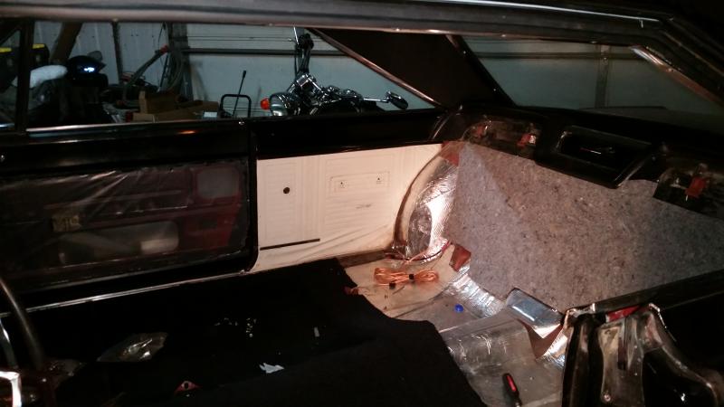

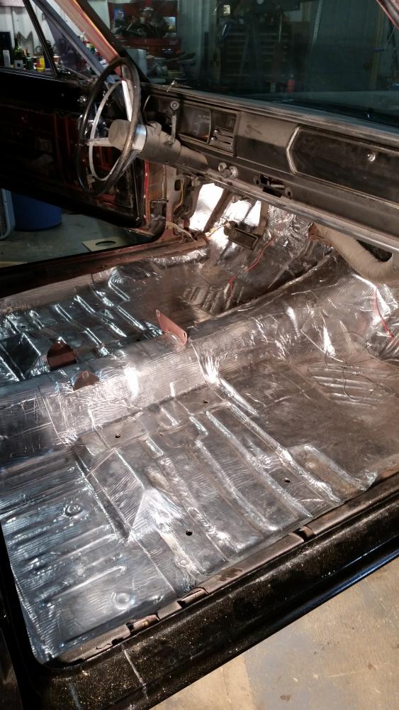

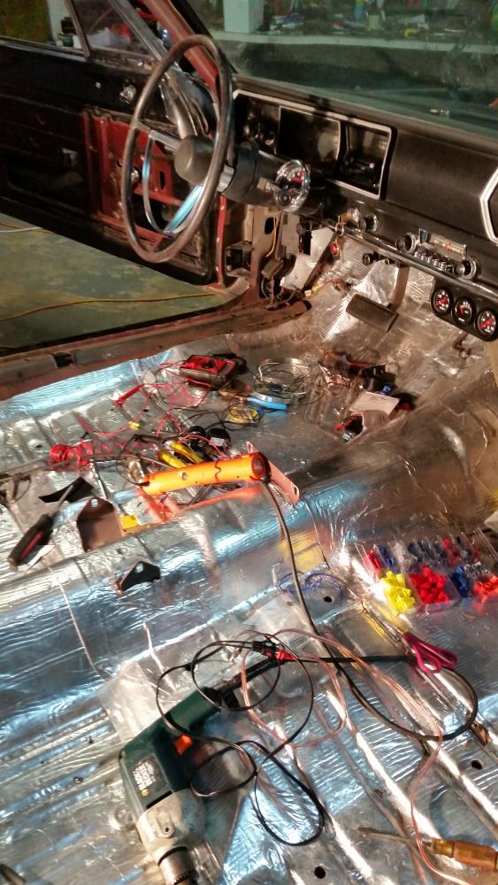

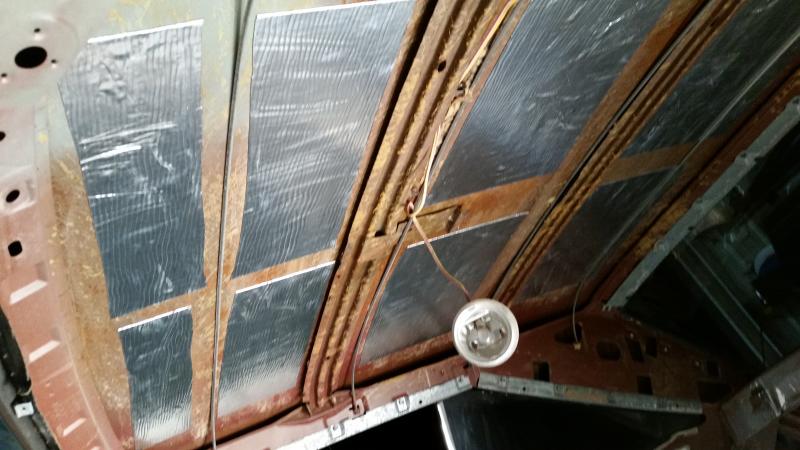

Next I started installing the Fatmat. That stuff really was a breeze, dont know why I was worried about it. An electric heat gun is the ticket with that stuff. Other that the fucked up burning chemical smell when using the heat gun, I didnt have a problem at all. And the smell was gone out of the shop and the car by the next day. Used two rolls, did the entire floor, trunk divider, package tray, strips on the inside of the door skins, wheel wells, covered about half the trunk and half the roof in strips. Noticed a huge difference in the door slam right away.

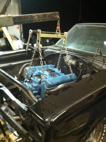

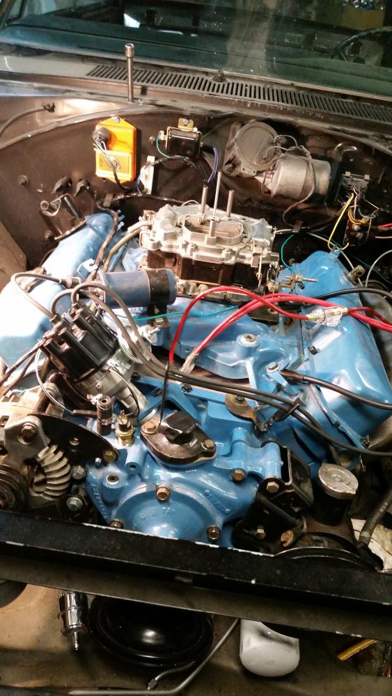

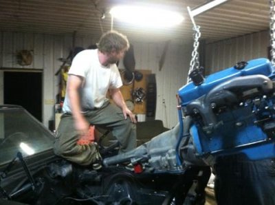

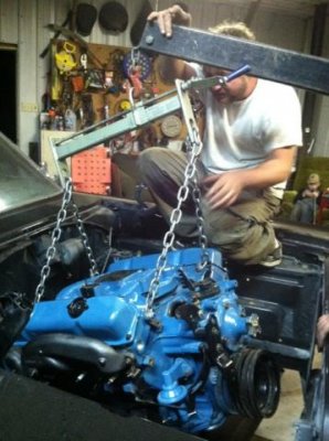

Then parts got here and I was ready to try to drop that big block in. 25% excited 75% terrified. Help from a good buddy and we had it wrestled in in no time. Surprised the sh!t out of me. Feeling pretty f'n impressed with things at this point. Over the next week got the carb on, linkage puzzle figured out, my new evans harness wired in, new starter, starter relay, ignition box, regulator all mounted and wired up. Primed the top end, set top dead center, and gave her a go. And alas, no fire. And the hunting began. A week and a half, a bunch of new parts, a new voltmeter, and a good lesson later, I found a broken wire in my new harness. My first electrical troubleshooting. Well played, dad. Well played.
Later that night she had her first combustion. I was pretty stoked. Next day put in the new radiator, shroud and plumbing, had a little trouble getting the fuel pump to prime but after a dozen tries or so, off she went!! Must have done alright with the carter cause she ran like a top right away, adjusted the timing a bit, held her around 2 grand and ran her up to operating temp. Couldnt have gone smoother. My good buddy, who is a hell of a good mechanic, was over that night to run the show cause I was a chicken ****. He was surprised too, said I done good.

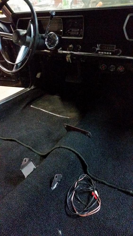

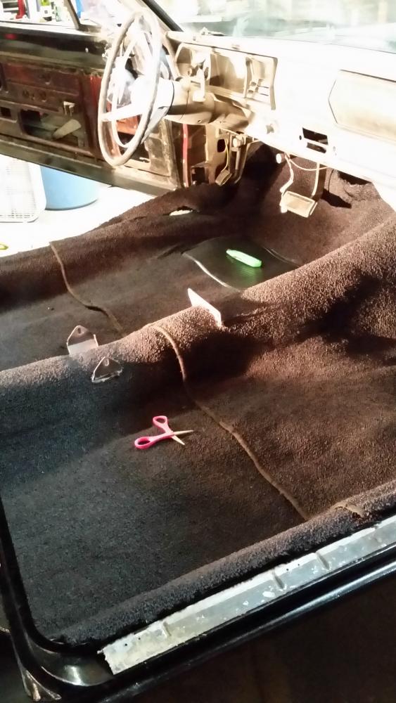

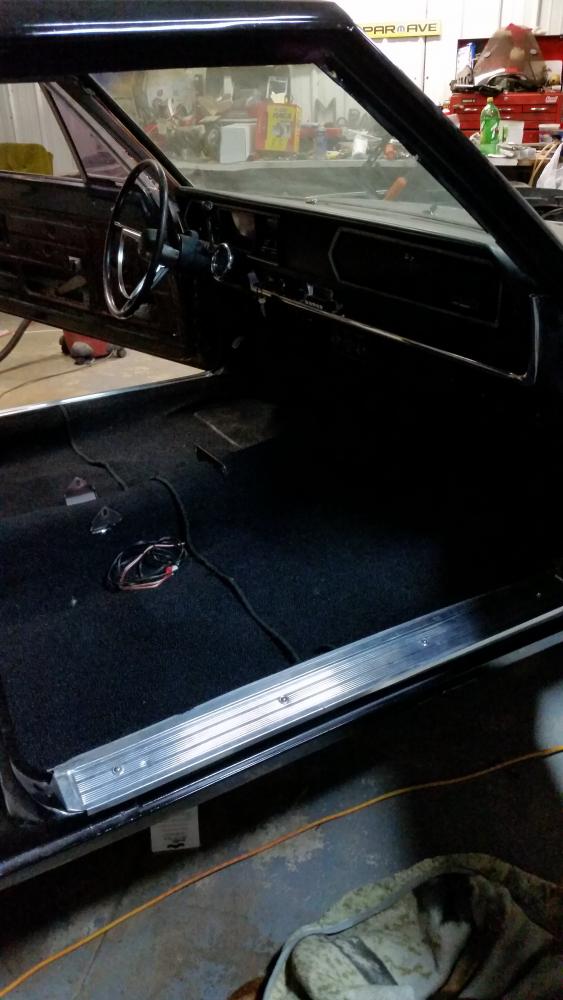

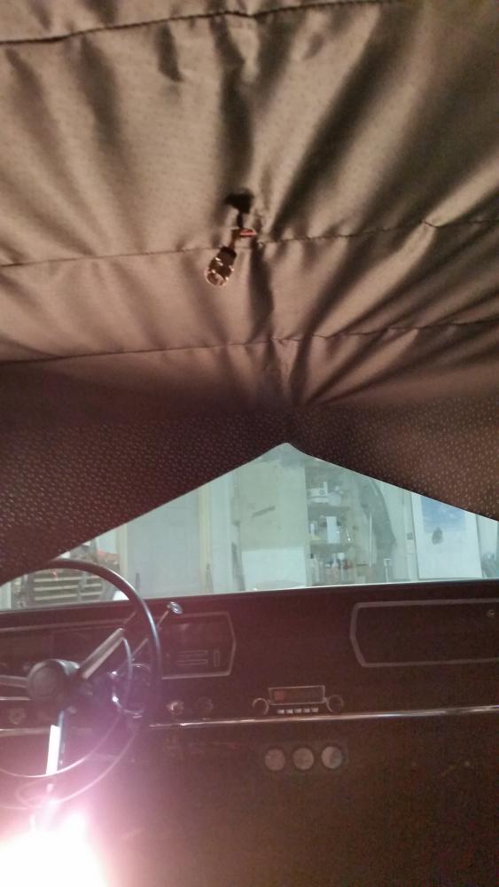

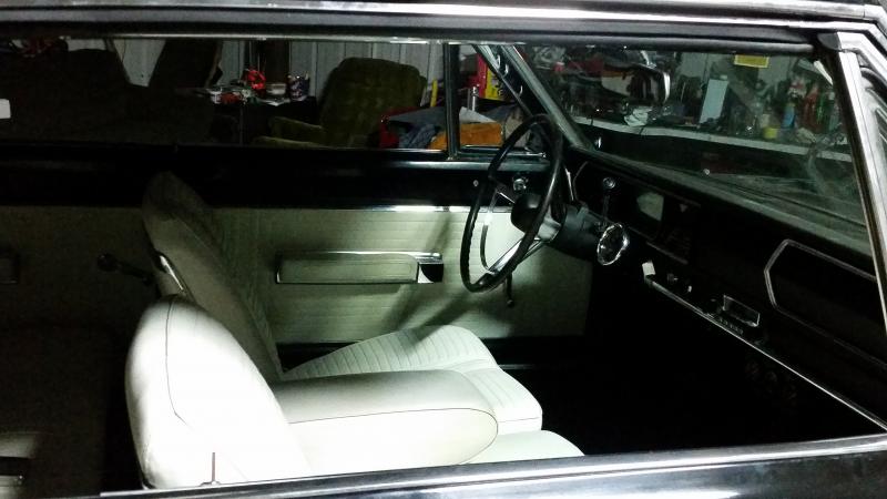

Next I wired in my little stereo. I ran an ipod straight to a nice little high fidelity amp and to two nice JBL 6x9s, and have to say Im quite impressed by how much stereo I get out of just two 6x9s. Highway speeds with the windows down, I can hear the tunes just fine! Then wired in a 3 gauge cluster and a Sunpro tach on the column. Everything worked and all lights dimmed, success!Then I continued with the interior. Put new carpet in, went in like a breeze. Took me three nights to get the headliner in. All in all, I'd definitely do it again. For $400 kept in my pocket, Ill live with the 2 wrinkles. A hairdrier is a must! Never got any pictures of it completed.

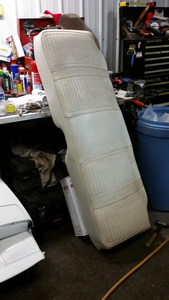

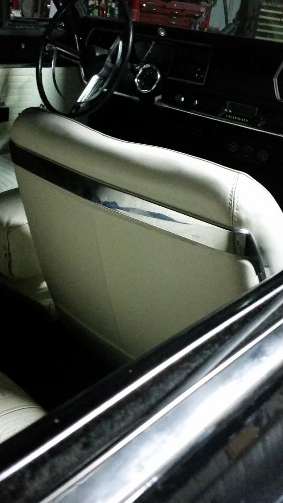

I learned one specific 'must' when working with that pearl white interior. Magic erasers. Holy hell are those things great on white interior. Magic erasers and an air compressor. Hours ahead! All the interior, door panels and center console cleaned up great and went back in great. All of a sudden it looked like a car again! And check out all that overspray.... on the inside... lesson learned.

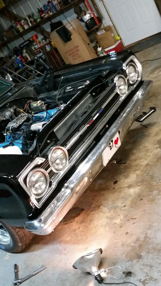

Finally I put her face back together, and she just smiled right back. Seeing the grill, bezels, bumper and hood back on got me even more wound up. Got the w/s and backglass trim on, back bumper, trunk panel, taillights all back together. Read a tip about painting the inside of your taillight buckets flat white to really make them pop, and right on! They sure do pop!

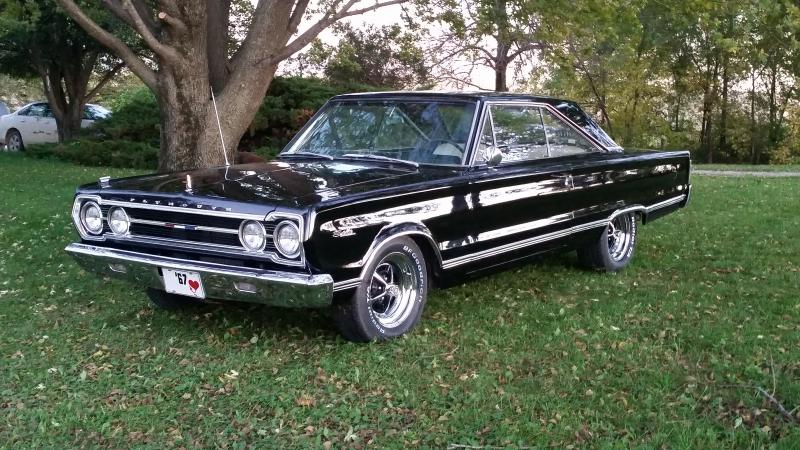

All of a sudden I was looking at a nearly finished car. Im not that naive, I know itll never really be done.

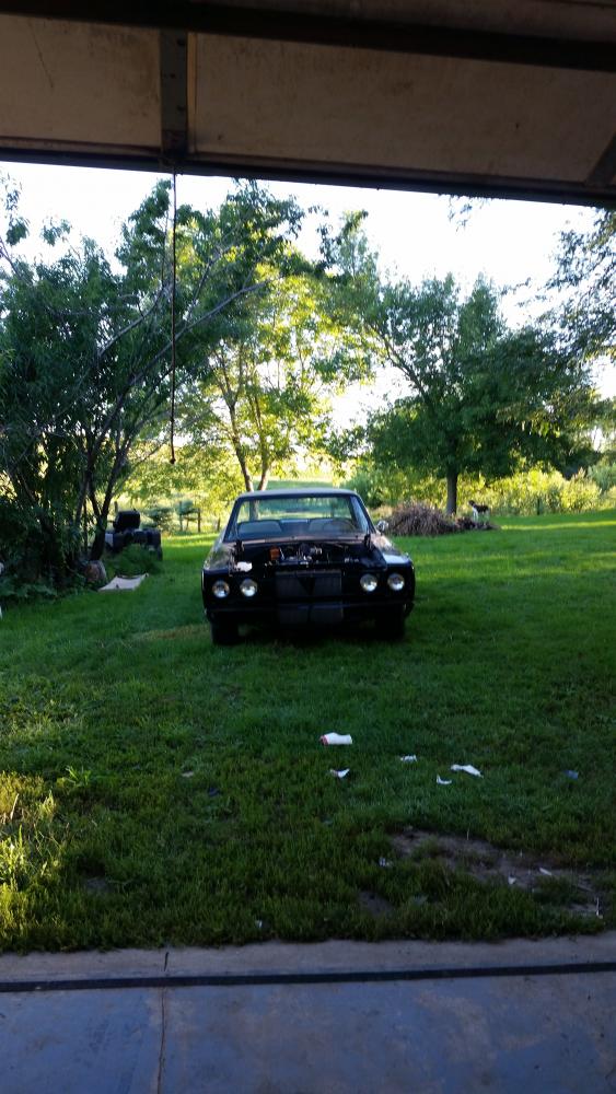

So she is all put back together, just turned 400 miles on the motor, so she's ready for the break in oil to get dropped, aaaaaaaaaaaannd, my wife and I move 700 miles away from my car. Iowa to Fort Collins, Colorado. That was the plan all along, but kept putting it off until the car was wrapped up. Two weeks ago was the move. So, from now until the day we move into a place with a trustworthy garage, Dads car is parked in his shop. Anxiously awaiting for me to come home for Thanksgiving.
