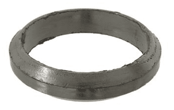

The stock type manifold connections usually work pretty well with minimal issues.
The gasket type I am familiar with is a donut shaped gasket that is fairly thick and has tapered ends.
These work very well. Although it might be a pain to do, loosen the nuts holding the exhaust flange to the manifold. Check the condition of the donut gasket and replace if needed. If replacement is not needed, just carefully align the donut with the two flanges as you tighten the exhaust - make sure it everything is lined up.
Good luck!
Magnum small block manifolds have a ball shaped end.
The headpipe opening is tapered and there is no gasket used.
