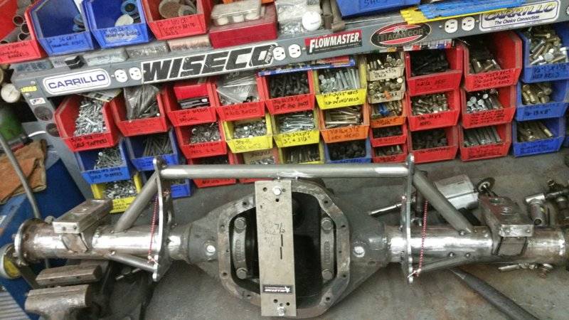

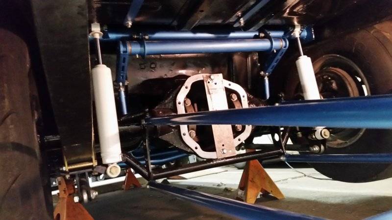

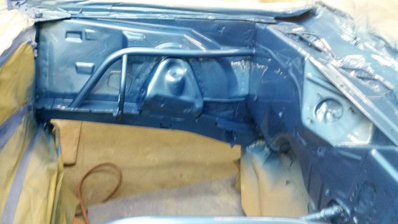

Some of my junk.
Challenger Progress 003.jpg 100_1667 [640x480].jpg 20150818_220204.jpg 20150824_212638.jpg

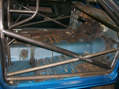

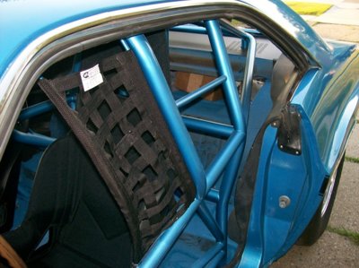

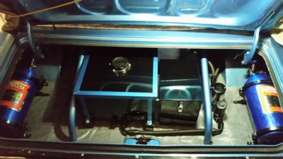

Never trusted the aluminum tabs provided on the aluminum fuel cells so I boxed it in with this extra hold down brace/mount. I have seen it with the G forces from launching that the weight with fuel tears the front tabs by themselves.
what a craftsman is all i can say. gives me the drive to get mine done
