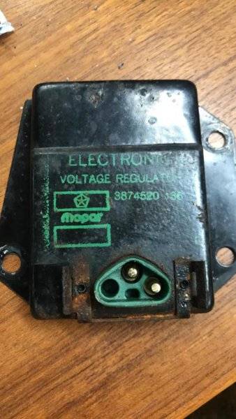

I have some charging problems. At idle I only get 12,7-ish volts and around 13 at rpm...
I made sure I had good ground at the regulator, but still had the same issues.
Then I watched this vid on youtube:
And this dude says a healthy regulator should have 1.75 ohms.
Mine had 156 ohms!
Can anybody confirm that my voltage regulator also SHOULD be at 1.75 ohm, like the ones in the vid.
Here's mine.
If that is what you are using buy a new one for about 40.00 and your problem should be solved.
