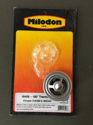

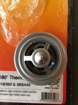

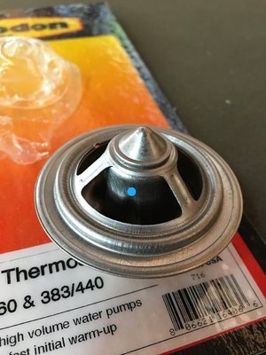

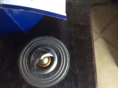

Funny - I checked it out and the builder never put a thermostat in when he rebuilt the motor. I just picked up a Stant *180 to put in this weekend. I just assumed - but wondered why the motor ran so cool. I've been running it for the last 2000 miles w/o one. Live and learn.....Hmmm - that could be. I better check that out. Never even looked. Just assumed ..... my bad for doing so.
