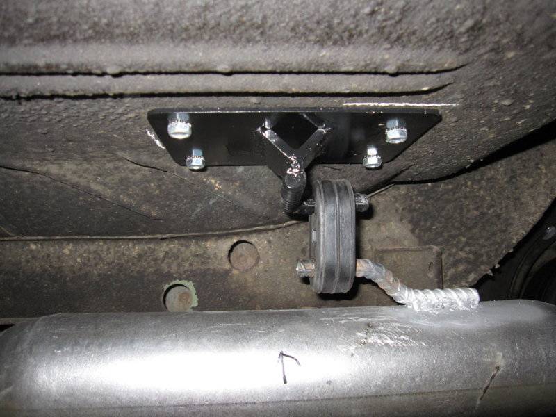

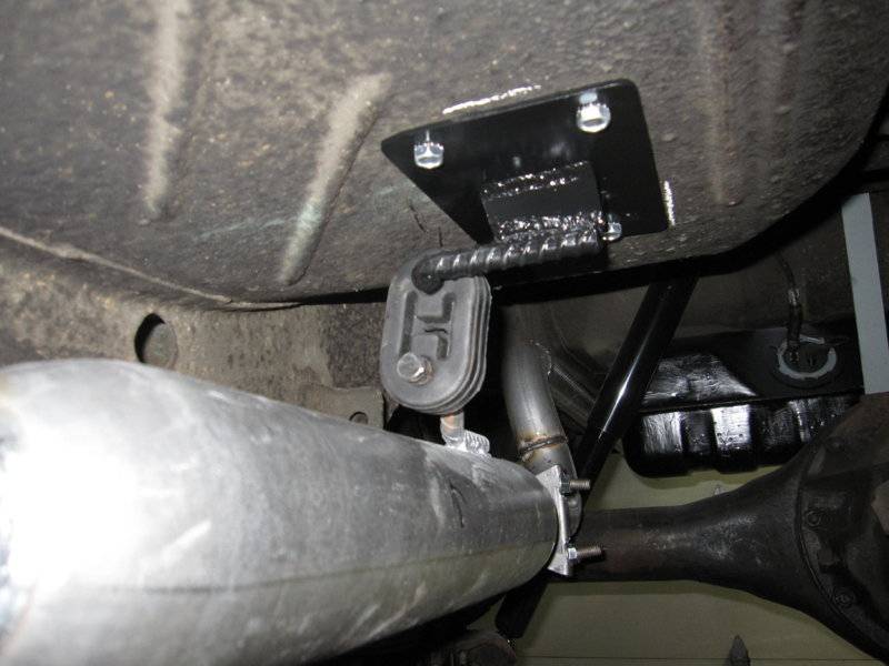

I realize these may take a little fabrication but, I'm using them on 2 of my cars and I just love em! Any 1/2" rod will work. https://www.rockauto.com/en/moreinfo.php?pk=132223&cc=1432095&jsn=429
Mike
If I can't traditional hangers, those will work. Thanks!
