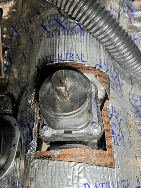

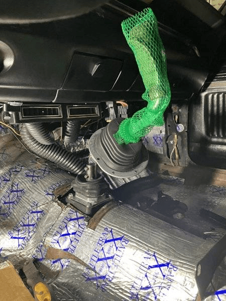

The cuts are in the tunnel exclusively.
This requires a much slimmer cover to close off the opening. Cardboard was used to make a template:
Steel sheet metal was then shaped to fit.
Seam sealer and it is weathertight.
The cutting was minor and could be reversed if someone wanted to return it to stock. The original carpeting even fit!
