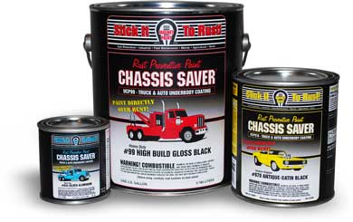

Here is the Chassis saver :
I will have to try the Master Coat stuff, I really had no issues with Chassis Saver, and now that it is in many colors maybe I will check out them also.
