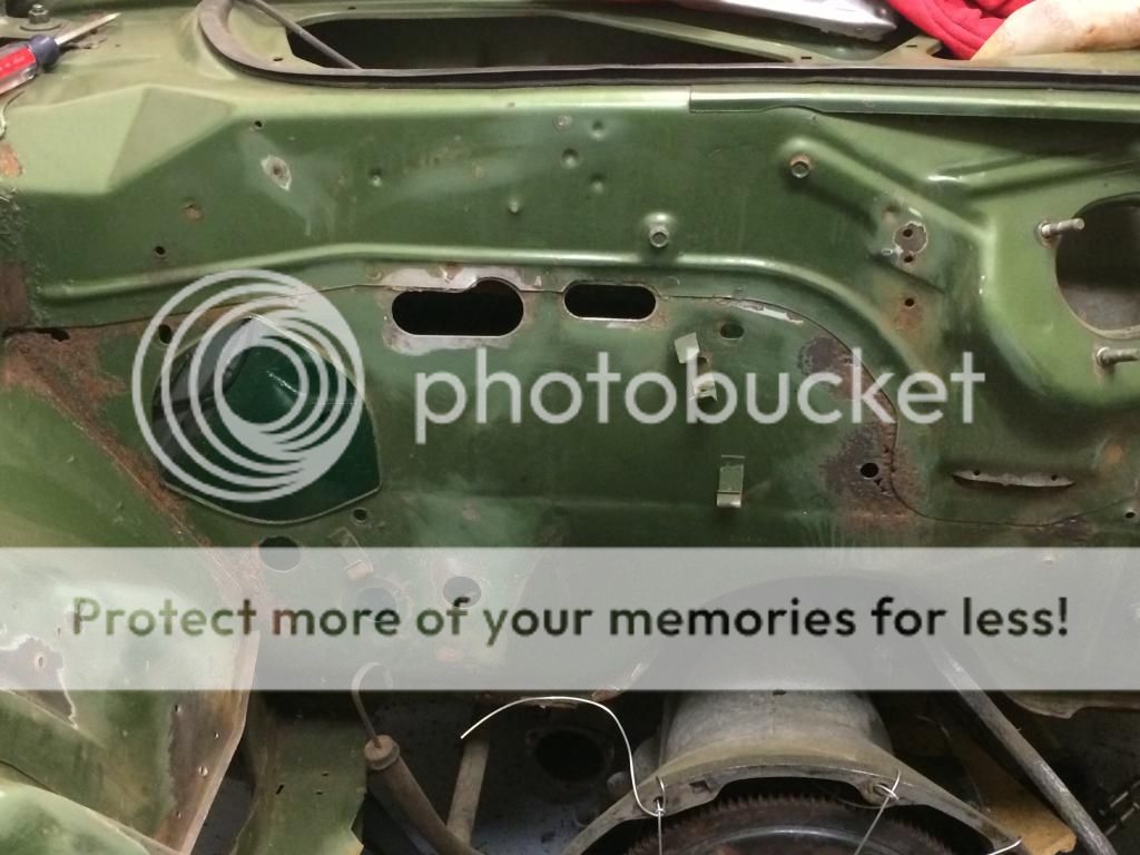

Hi guys, I am fixing to paint the engine bay of my 71 Charger.
There is very little rust, but some areas of surface rust and some pitted areas.
What would you recommend as far as neutralizing the rust and filling the pitted areas before another coat of paint? I will be doing the paint myself with a Preval Sprayer.
Also, the very worst areas are these two spots on my firewall where the pitting has lead to a couple holes. I don't have the time or money to replace the sheet metal, but what would you guys recommend for stopping the rust in its tracks, and then filling the small holes? (Fiberglass from the interior-side perhaps?)
i would sandblast those spots, epoxy prime, fill the holes with some sort of 2 part epoxy then a little filler on top, reprime
CLEAN ...ospho ,CLEAN.. then fill with all-metal, CLEAN .. ...etch prime ...... CLEAN CLEAN CLEAN !!!!

you could wire wheel it all and use chemicals if you really had to
blasting is the preferred/best method
the filler is for pits and small stuff ,not larger sized holes
you might get away with it but
welding in a patch is preferred for that
things like this can come back to bite you in the ***
in the future.
even with blasting i would at least try to ospho up that seam
from the inside letting it seep thru as much as i could.

Yes it sure will. Just be sure to prep the metal first, wire wheel as much as possible and try to recess the holes before filling. All metal is good ****. Little advise, do not let it fully cure Before trying to sand down, it dries very hard! Start sanding it as soon as it starts to set up, will make life much easier! Don't be afraid to sand Down and apply a 2nd coat if needed. Great thing about that stuff is you don't need to glob it on, usually a thin coat will do.
Here is another option:
Blast to clean away rust. (can use a hand-held one from Harbor freight).
MIG weld against a copper back to fill the holes (low-heat, slow, 0.030" or smaller wire, less is more). A nice large piece of copper behind the panel (two man job and the copper gets very hot) with small weld plug holes to fill.
Then blend welds down GENTLY with a flap disc.
Treat rust with Rust Converter and epoxy prime and smooth with all-metal if needed.
If you get good with the MIG and the Copper you can fill small holes pretty well. make sure you get to some good metal though and not recommended if its really swiss cheese. You will be welding forever.

Jenkins, these areas are very bad. Most of the methods listed will result in your chasing your tail. These areas must be media blasted. You have a lot more damage here than you think, you never know until you get it blasted. Trust me, I've done hundreds of cars and parts, and I know what I'm looking at. You will likely need to replace the entire firewall - why? Because it's not worth fixing, you'll have patches everywhere, and I sort of doubt you or your helpers will Butt weld patches in. You're going to have heat issues, so warping will be challenging. Copper spoon and welding the holes up will not work, the metal is too thin to render this sort of repair, plus, you'll tear it up more attempting to fill and repair in this manner. Good luck. Look at the pics I have at drblast.com
Thanks for your words Donny, but I really can't afford to replace the whole firewall at the moment. I'm not sure about welding either. I think I will just neutralize the rust and cover up the damage as best I can.
