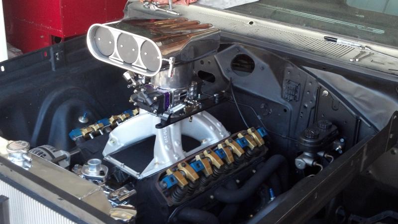

If you need or want to put that 1" spacer back get a hold of Mancini racing .com and ask for the AR engineering throttle bracket works great. here is a pic.
