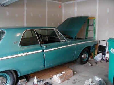

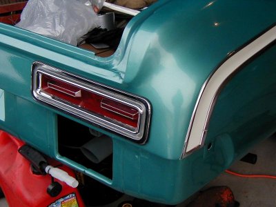

Went out and worked in the garage today.....warm boots amd two heavy sweat shirts...and pants. Installed one of my new heads....will remove the other one tomorrow and get them shipped.

Nice! I'm turquoise with envy!

No, it's not, she'll have to wait until July for me to save up, but I guess that's how it goes. Now, more importantly, I can't believe everything that's been going on with your car! It's been really great for me to see all of this progress! I love that paint!

I love the second picture you posted! That's the garage of a true car guy! Raw cement floors, unpainted drywall with spackle and tape showing, orange extension cord hanging down... lots of work to be done on the garage but you're in the garage working on the car. I love it!
I get so tired of seeing ads and mag pictures where the garage is spotlessly clean, there are high-tech organizers and bins everywhere, specially painted floors and walls, and some 100-point 69 Camaro parked in it with a owner nearby who bought the car at auction and has never touched it with any of those well-organized snap-on tools hanging on the wall and never will.
Let me tell you how bad it is.....the garage is 19x19 and is considered a 2 car garage. IF you put the garbage can in it you have to put it between the 2 cars and then squeeze around it. I have a roll around 2 tier tool box and I don't have enough room to put it in the garage so I put a lot of my tools in small tool boxes that will fit against the walls. Talk about a PITA, dump the boxes out to look for a tool.....thanks for the kind words!
But then I remember what it was like when I didn't have a garage at all.
I can sure relate to you on the garage, mine being almost the same size.. You said it right for sure... I have over spray on the exhaust fan, walls look like they been used for practice on something in places lol, thats what its for though, beats the maple tree in the yard! Your car looks good in there red, nice to know there dry and out of the weather for sure..
