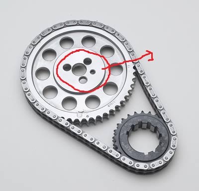

yes the circle thing the spockets (picture below)when i rotate the spocket THING dnt know what is called ....it makes a slight grinding sound...(sorry for not getting the message/problem clear its my first car and yeah....(and about local help the garages here are rubbish and most people dont work with mopars(moslty they work on chevy and they litterally tell you they wont work on dodge cars...there are only 2 registered roadrunners in qatar(im just saying lol:)

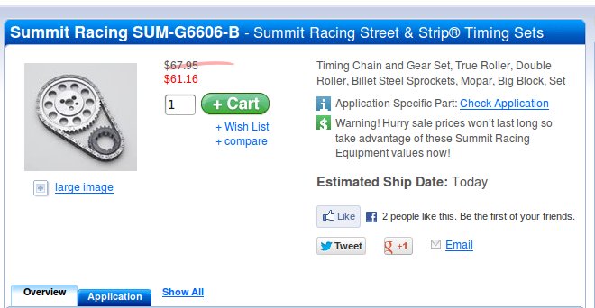

I have no idea what you see. The link the OP posted is the screenshot below, which is a conventional timing chain and sprockets I don't give a $$$$ what Summit calls these they are not "gears" they are a chain and sprockets.

Grinding noise from the gear set when bolted to the cam would be bad cam bearings, pull the cam and gear set out and have a machine shop replace the cam bearings and clean and inspect the gear set and chain for wear and debris if you find damage on the chain or gear then replace, (also check the lower crank gear for damage and binding with the chain and top gear.) rotate motor and check the whole gear set. is it hitting your oil slinger? You need to pull the cam out and check it as well as the lifters and push rods.
You need to isolate one sproket from the other by removing the chain. That way you can tell for sure where the grinding is coming from. If it is the cam bearings, go here and check out my cam bearing install how to.
http://www.forbbodiesonly.com/moparforum/showthread.php?t=38645&highlight=cam+bearings
That is step by step instructions on how to get the job done.
the timing chain is not in the car yet...im just turning it by hand(the part circled in red in my abouve post)and it makes a small noise....
Did you lube the camshaft before you put it in? It might be a good idea to remove the cam and get some good pics of all the cam bearings and post them for us to see.
