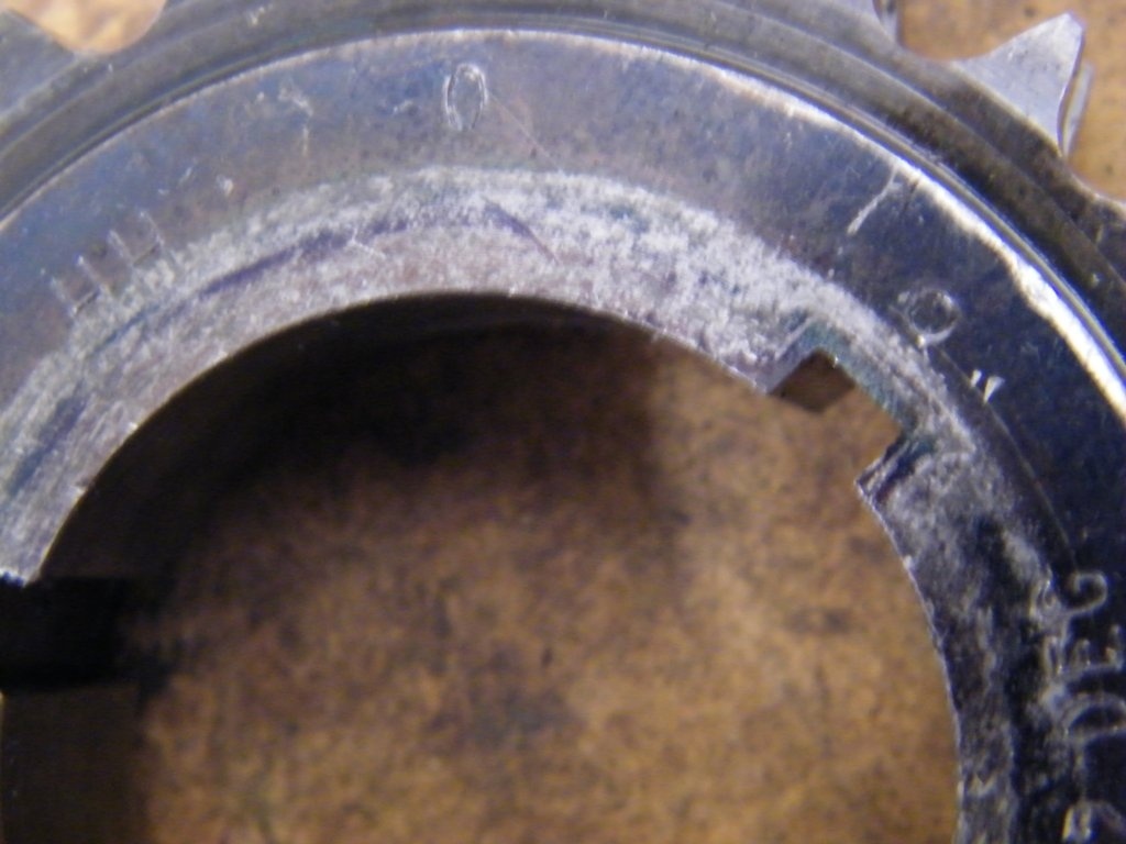

I installed a new cam, timing gears & chain in the 440 last evening. The crank gear has 3 keyway slots & I lined up the "0" with the punch mark on the cam gear. No problem there. Put the timing cover on but when I put the balancer on on, the timing mark was a couple inches off from the TDC mark on the cover. It's been a while since I did a cam job and I just want to check with the experts here to see if this sounds right or not.
Below is a picture of the old gear with the 0 mark that I lined up with the cam dot....
You might be looking at the balancer, that the outer ring has slipped. Just ballpark, but from the keyway groove, to 0 mark TDC, should be right at 90 degrees.
Best on timing the cam, to use a dial indicator/degree wheel, and check things off top of piston.

All engine timing is off top dead center of the number 1 piston. If you are at TDC the keyway for the crank gear should point straight up. When the gear is put on, if a dot exists, it should be straight up. If it's a multi keyed gear there will be a number above the slot to indicate how much advance/retard that position will render when used. When the cam is in the right position in reference to the crank, #1 intake and exhaust should be closed and the lifters on the base circle of the cam lobes for those particular valves. Then, and only then, can the chain and sprockets be installed. Slots in either gears allow for slight advance or retarding of the timing between the crank and cam and I would suspect that either a gear is put on backwards or the timing marks are not at 0 position. This would be because you've used a key slot in the gear that is for more advance or retarding of cam position. You must leave the crank at TDC and not move it when you apply the timing chain. Only the cam is to be moved. Examine your gears closely for their markings and positions and redo the operation again. If it's not right you'll run out of distributor adjustment, be subject to farts out the carb and generally have a poor running engine, if it fires at all. Use your original gear to verify the tooth position on the new gear for TDC

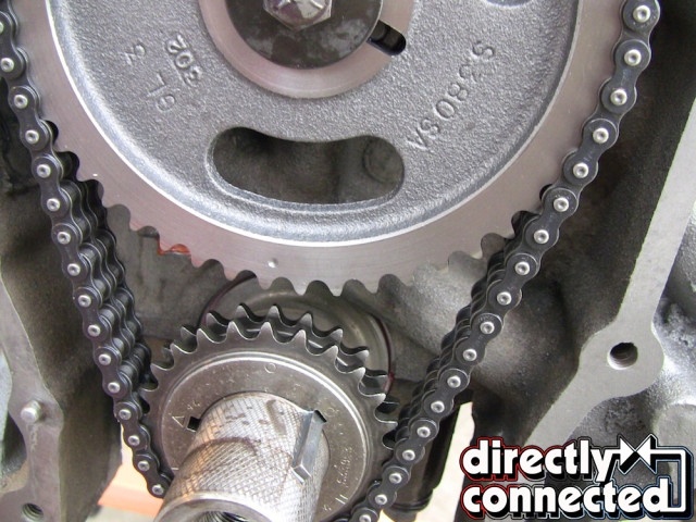

I thought of the slipped balancer, but this engine already does have a new balancer. I was looking at a video on line (below) & the crank keyway on that video was positioned at 1:00 to get the two gear marks to line up, but crank key on mine was positioned at 11:00. I think I've got to pull the balancer & cover off to take a look at things again.

At TDC the key for the crank is at 2 o'clock.

I now see where I went wrong; somehow I got the crank got rotated into the wrong position. My crank key is in the 11 o'clock keyway slot, not the 1:00 o'clock keyway. Silly me. :realcrazy:

Don't forget to rotate it over another turn to get tdc on #1. With the dots together it is tdc on #6, with both dots at 12 oclock on their sprockets you get tdc on #1.
