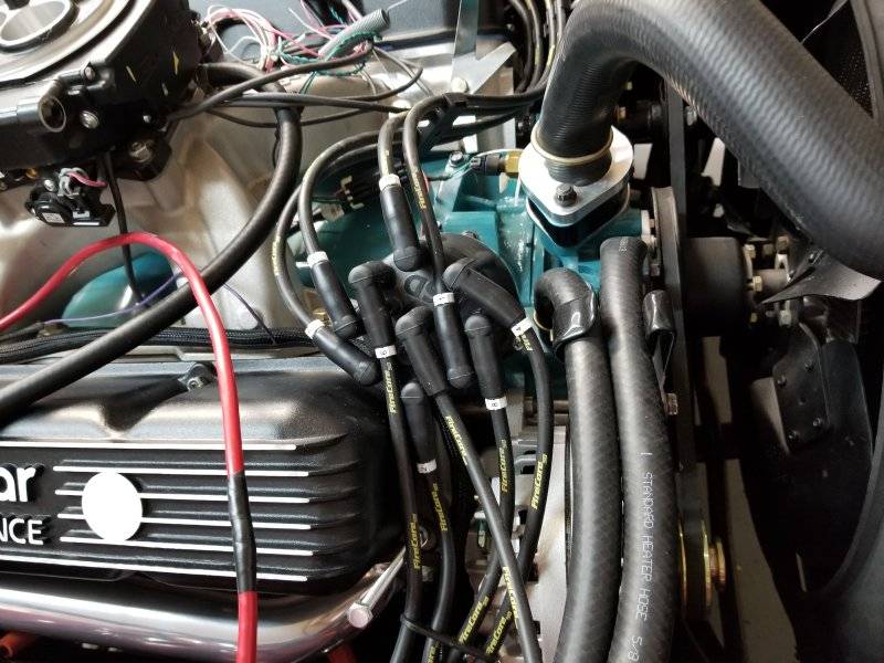

Having problems getting this engine to run properly. I think timing is the issue. The pic is with #1 TDC on compression stroke. The rotor is at about the 7 O'clock looking from front of car. In this position it aligns with the designated #1 on the cap. I've seen other photos where the rotor is not at the 7 O"clock position. I'm thinking it's 180 out but I don't see how
as long as the rotor is pointing to cyl 1 on the cap, with the engine about 10 degrees before TDC on cyl 1 compression stroke......it will run
the orientation of the distributor does not matter, as long as it can be moved a little in either direction to dial in the timing......
180 out simply cannot run
double check your firing order
check for vacuum leak at the intake gasket

You have to watch the factory setting some of the big block dual points are indexed differently than a say single point also. Follow post two he is spot on.
Looks correct.
Did you pull the number 1 plug and feel compression with your finger?
I would give it some advance.

Yes. The engine was previously run on dyno. About 2 years ago. It ran well and made good numbers. I wanted to get some oil pressure before attempting to start engine after finally installed in car. I tried to do this using starter but no pressure was being produced. So I removed distributor and spun the engine over with a drill. Made pressure after about 10 seconds. Good pressure. I posted about this because I've never done before. It was recommended to rotate engine while spinning oil pump with drill. So did this too. Started at TDC on compression stroke and rotated engine six complete turns and ended up back on TDC, as determined by timing mark. I marked where the rotor was before removing distributor. At end of six rotations, distributor was reinstalled and rotor was in exact same place as when I started. Thats why I stated I don't see how it could be out of time but it runs horrible. Nothing else on the engine was touched. No carb but Holley Sniper and it has not been touched. Distributor, a Holley Hyperspark unit, was only part of this engine tampered with (remove/reinstall). Nothing else - except plug wires those were added after dyno runs.
so you pulled the distributor and put it back in "close" to where it was......sounds like you need a timing light, 10 degrees in either direction, anywhere near TDC can make a huge difference...... and after 2 years, you may have multiple issues; I'd open up the carb as it may be jammed up with nastiness from old evaporated gas
