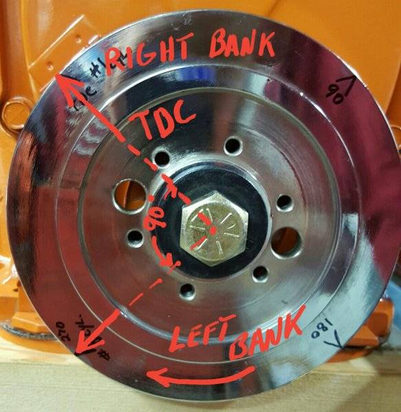

Thanks Khrysler. I would prefer to turn engine over a minimum while priming motor. Do you know where on the timing rotation the cam oil ports and the top end line up?
Hey JG, I've never done this on a small block but it should work. You'll have to let us know.
Bring #1 cylinder up on compression stroke and stop at top dead center. That should have the cam passage lined up for the right bank. Spin up your priming shaft and watch this side.
Now rotate your crank clockwise, one full revolution and stop at the 270 degree mark. That will have it lined up for oiling the left bank. Spin up your priming shaft and watch for oil there.
If your cam has been degreed any, the oil passages might line up a bit sooner. Probably not enough to throw things off though.
