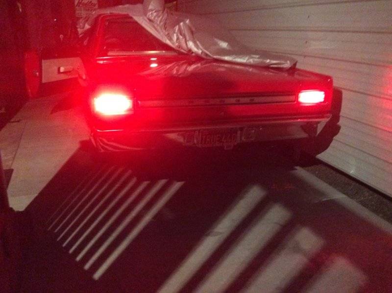

Had some hassles with LED tail/brake lights then came upon a set that worked nicely - brighter to warn the shitwads who tailgate a bit sooner. Except the turn signal/running light LED's I got with the set was a different deal: When I'd turn the directional left or right BOTH would blink! Regular bulbs worked fine and this is after a new wiring harness. Got another set of LED's sent to me and same deal. So I have the LED's in back only...go figure.

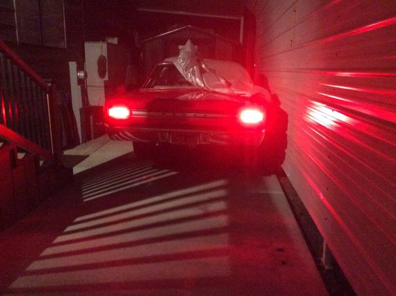

I wanted to change to LED to reduce the current through the bulkhead terminals and the rear harness. (Dim lights at idle) I ended up changing up all bulbs for dash, interior, side markers,t taillight. The lights were still dim, so installed relay for the headlights/ increased the wire size, connected big cables directly from alternator to start relay (with fuseible link). Headlights are much brigher, but still a bit flickering at idle. Now I'm waiting for a new 90amp alternator :icon_fU:
For the taillights I didn't like the instant on/off on the LED's, so I opened the LED bulb and did some research for the LED driver that was implemented inside the socket. The outcome? I removed the printed circuit board inside the socket, and made my own PCB's (2x PCB's stacked inside the socket). Now they turns on/off slowly as a incadesent light. A lot of work for a small detail ...:drama:

No led flasher, no resistors, no upgraded anything. Just hard wired them in and work perfect. And man are they bright. Visible over 2 miles away.
