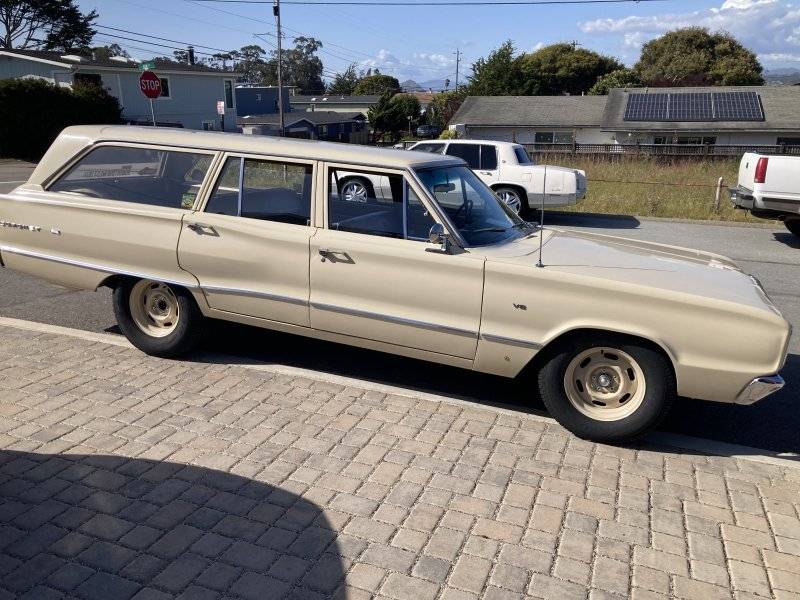

Coopers for me too. Had them on the 65, have them on my 04 dually and the 67 wagon. Great tires plus US made.
