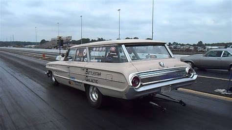

My procedure starts at the second bulb. Get on the 2 step and my left leg starts to move when the bottom bulb comes on. It's amazing how much time it takes to get the stick car moving from staged to green. It's amazing how some racers like Larry(Battlestar) can be so consistent by leaving old school just mashing the gas and letting it fly on the bottom bulb .
