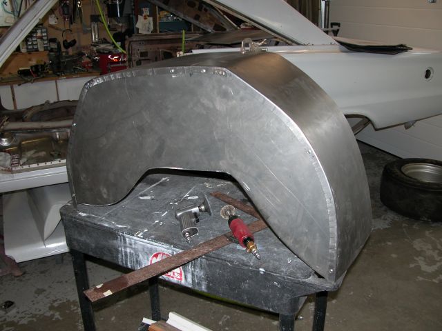

This is the problem with these beauties, I wound up going to the xtreme and mini tubbing/spring relocation kit...A lot of hand fabrication but will easily accomodate up to a 13" tire, I will likely use a 12x28"...
What are you going to do about leaf spring location? Ok you cleared the wheel well but not the springs? Nice tubs though can I buy a set?
Building the first side bas been trial and error, I now have it welded in and I will post some more pics soon. I have kept the templates and will try and put a step by step procedure together. I am replying on my phone
And will give more info tomorrow! Thanks for the compliments.
