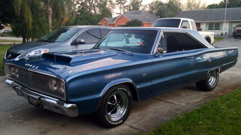

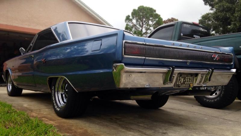

If you run 15x8 rim with 4 1/2" inch backspacing you go with 255/60/15 if you run a 8" rim with a 5 inch backspace you could most likely run it to 275/60/15 but the diameter of the 275/60/15 is 28 inches anything taller you probably have to run like a 70 series tire. I went through the trouble of shortening my axle a half inch on each side just so I could run at 275/60/15 tire on a 8" rim with 4 1/2 inch backspace it was worth the 180.00 for the chop axles
Your car looks awesome badmopar67, love the stance, color, everything about it...
Thank you fellow Mopar heads on the front I'm running 225/60/15's on a 7 inch rim with a 3 3/4" backspace. I like the sidewall height on The front tire not to be a taller than the rear.
