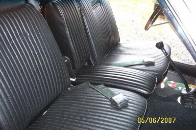

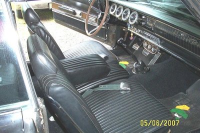

my 66 Charger is original 4spd car...I actually have a pair of them. What I did was take the console & shifter handle out and make it a 67 style without console so people could see the difference between the 2 when parked side by side. The shifter handle on the console style is crocked to come through the top opening
The Inland style was from 66 to mid 68 cars, then they went to Hurst linkage
Bryan
