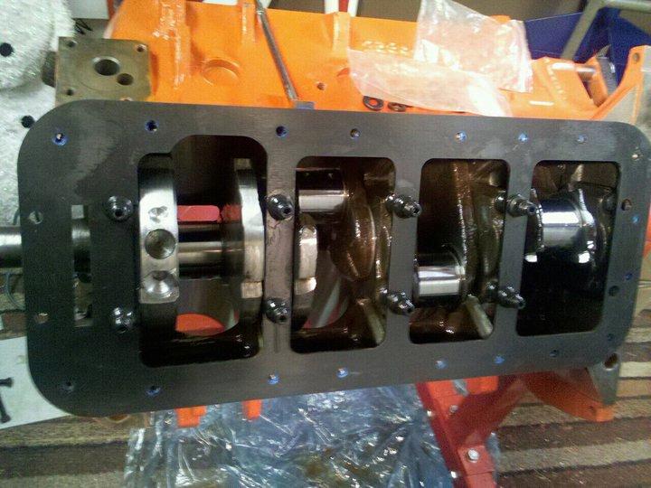

mine
One other note,,,, You'll have to be sure that your girdle has the hole in it for the dipstick....
This is mine before the hole was added......
