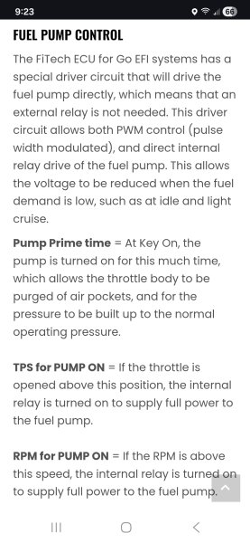

My FiTech 1200PA does not use a relay, the ECU powers the fuel pump with the option of Pulse Width Modulation (PWM). for pumps that need constant power I think you just set the PWM to 100% (It's been 10 years since I set it up, but I think that is how it was done?)
I don't know the posters setup is that he needs a switch. Every EFI system I have used has the computer turn the pump on and off, either through a relay or PWM like the Fitech.
To clarify, prior generations have PWM with an internal relay and an in-line fuse.
Current units have external relays, fuel pump and main power, and fuses.
Also, turn the key to run, fuel pump primes the tb then shuts off. It does not run continuously.
