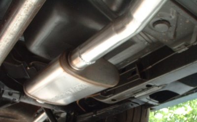

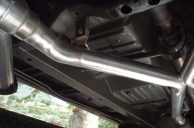

Here are some picturesof the US Car Tool frame connectors I installed on my 66 Hemi car.

As you can see in my pictures above, the advantage to these is that they are lazer cut to follow the conture of the floor and therefore don't hang down lower the the unibody like others. They look like they were there from the factory and one piece from the front to the rear of the unibody frame rails.
It does look factory, i wasn't aware that the others hung lower. it was a little strange that the hotchkis connectors come powder coated and then you have to grind it off in order to weld. and the tubular ones look out of place.

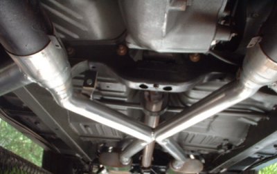

where do the sub-frame connectors go in relation to the torque boxes? can you show me pictures of this?
Here are a couple more pictures showin the torque boxes and frame connectors togather.

I don't know if any one mentioned this already, but your satty vert would have come factory with torque boxes.. All cars in 68' that is a hemi/vert has them. Good luck on your build..Post some pic's..
yea, somebody did mention that. my question now becomes - which frame connectors can i use? apparently some mount up to the back side of the leaf spring hanger, which is inside the rear torque box. so, i don't want to cut that up, right?
