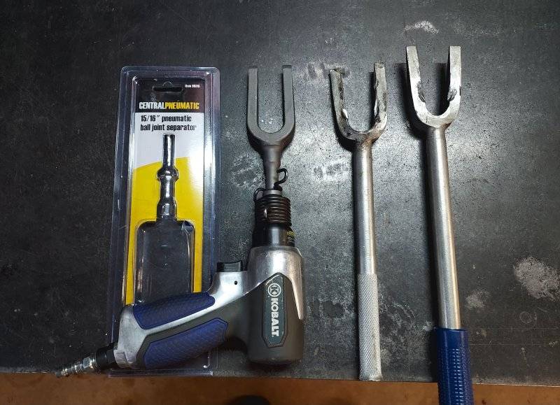

I've never had trouble removing a ball joint.
I was trying to remove one lately and I tried everything. I had to use the longest strong arm I had just to remove the nut. Then I went through two pickle forks, beating the heck out of them. Tried heat and more beating. I had to straighten out the pickle forks twice and deburr them hoping to get one of them to work.
I finally had a thought about using my air hammer. Went to China Freight, I mean Harbor Freight and for ten bucks bought a fork for it. About ten seconds of hammering it popped loose.

Yes, for ten bucks it's worth a try. Definitely it's case hardened. It didn't even show a scratch on it after I used it.
The other forks I don't know where they're made. They're soft for sure. I've had them for a long time and never had a problem using them. I'll try using a hammer on the side of the ball joint or tie rod and normally that will pop it loose. If not the pickle fork always worked. Not this time. These will end up in the bottom of the bottom drawer.
