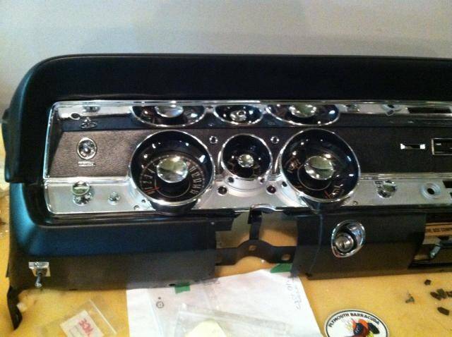

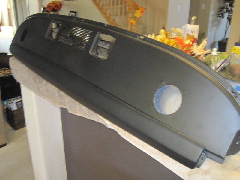

John Deere Blitz Black. Rattle can. 3 years on the Coronet and still looks good. Has a slight texture.

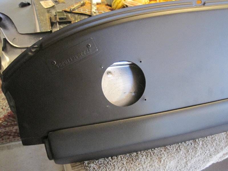

I’m getting ready to spray my dash and was just gonna spray it satin black with a coat of clear or two to protective it
I used ppg hot rod black with ppg dx1999 texture additive, 1 oz per of dx1999 per un mixed quart. Worked well
Satin black, if you clear obviously use matte clear. I’ve had gloss dashes before and never had to big of an issue. Throw on some polarized sunners and there won’t be any glare! Lol

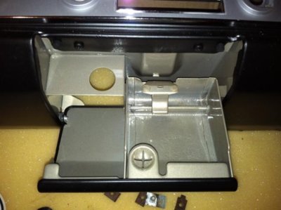

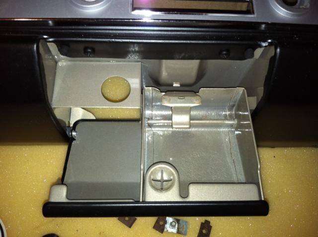

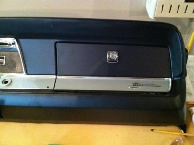

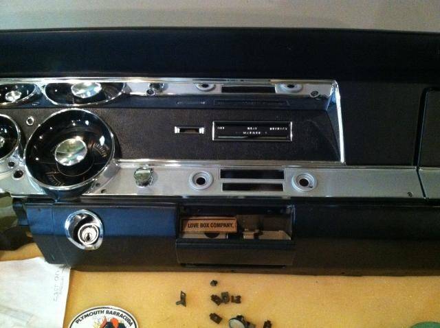

Our own Leanna from Phoenix Speciality Coatings did my daughters dash. Absolutely flawless, and even did the ashtray. Top notch work, and of course very reasonably priced!
F21783BA-ECFB-467E-BA48-6242318D7694.jpeg 0B3B94B1-A7CD-43F3-9612-3D4942302F9C.jpeg A9AD9D77-9FB5-4371-BE95-DBA2997A3212.jpeg 13FAA9AA-67BC-4FF2-95AD-93B0E80EAC0F.jpeg

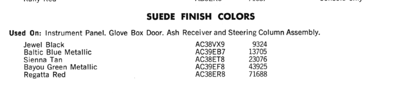

The correct finish is suede, the color is Chestnut Poly & the Ditzler code is 22754
If you have the shop manual, the codes are in section 23. (this is a 1969 example)
The first numbers are Chrysler codes, the second are Ditzler.
