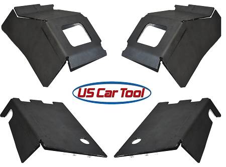

Torque boxes
This is an A body but same idea
As mentioned, torque boxes add stiffness to the car. Only you can say if they would benefit your ride, as they are a couple hundred $$ plus the prep and welding.
