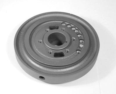

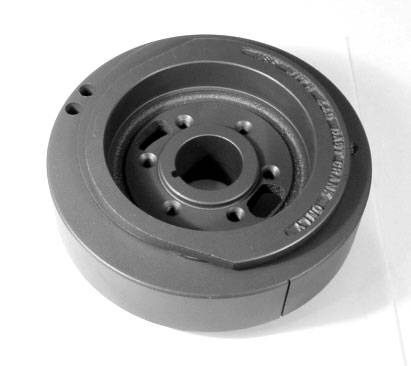

how do you tell if your crank is a steel crank or a cast crank? internally or externally balanced?
cast crank:
forged crank:
all internally balanced engines had the thin harmonic balancer.. but... generally speaking, all 383's had a forged crank, all 400's were cast crank, all 340's up to 73 model year were forged, then in 73 some were cast cranks, 318's are all internally balanced engines, 360's were all cast externally balanced engines, 440's up to 71 were all forged crank motors, then in 72 they went to internally and externally balanced (i.e. forged internal, cast external). Some 440's in trucks up to 78 model year had forged cranks in them, but a VERY small percentage... some early 70's 440's in trucks had forged cranks, but only if they were mated to a 4 speed transmission, and that is a rare occurrence. 273's were all internally balanced.. hemi's are all internally balanced.
hope that helps but I do not know about /6's.
needless to say.. if it has a cast crankshaft its externally balanced and if it has a forged crankshaft it is internally balanced.
