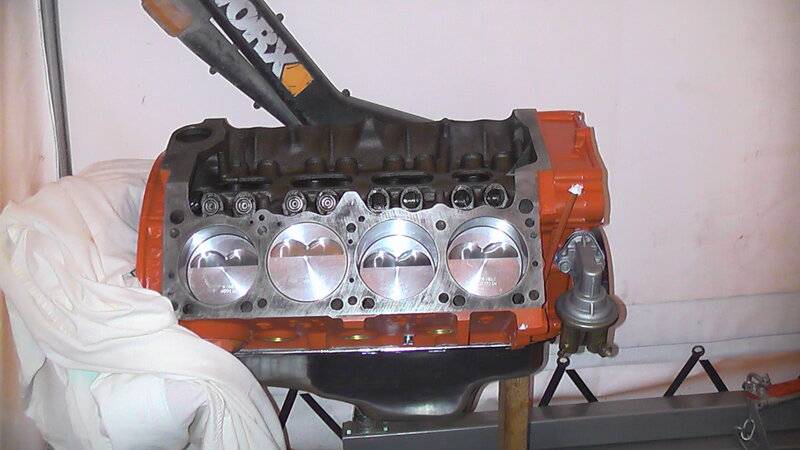

well hear goes. 360 30 over 9 two 1 comp, headers,edelbrock rpm performer,650 dp,262 comp cam,stock 188 valve heads,904 tranny, going with 355 gear, now that cam is small going to break it in with it and in a later time going with something bigger,but not to big i have power brakes.the 71 is street driven,but would like to take it to our local strip once or twice .maybe 350 hp.

wy the 360 is on a engine stand, just garbing parts for this winter engine swap, thanks for the advice.
