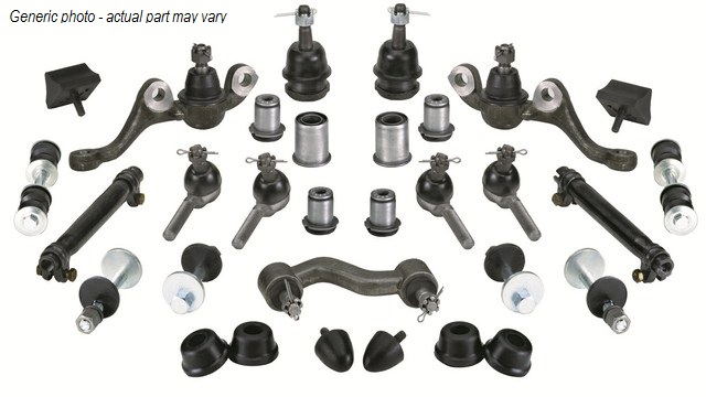

Ordered the Mopar Performance .92's yesterday based on recommendations from other '62 wagon owners. Should improve the ride big time. Also have PST sending the rest of the front end parts that I don't already have: Steering kit with idler, pitman, tie rod ends and sleeves, LCA pivot arms and bushings, LCA and UCA bumpers, new adjusters, polygraghite one piece strut rod bushings, and torsion bar seals and clips. Time to learn how to rebuild Mopar suspensions. :icon_winkle:
Rear suspension is next.........
