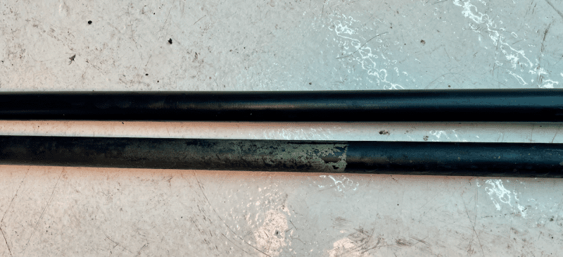

Here is one. Sorry it is not good. I tried a few times, but all came up blurry.
