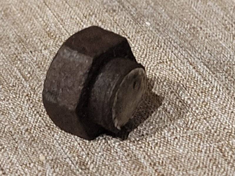

So, both torsion bar adjusters on my car were frozen solid. After 3 days of marinating in WD-40, the LH side broke free. The RH side chose to go a different route (suspension was unloaded.)
I'm stumped how to get the bar off now... My only idea is to jack the car up to unload the suspension, start cutting through the bar and wait for it to snap. There is a ton of energy stored though, so I really don't want to do that. I *think* it would just (violently) unwind, but nothing would go flying. But would rather not bet my life on it. Anyone else ever deal with this? Any better ideas?
Pop the upper ball joint stud out of the steering knuckle. That will allow the lower to go all the way down.
Never tried that with the suspension under tension. Jack under the knuckle to keep it from snapping down?
You need to let the suspension hang. Jack stands on the frame. Then a jack under the lower control arm. Lower shock bolt and pop the upper ball joint loose. Lower the jack.

After it's jacked up with the ball joint seprated I'd torch the remaining bolt off above the cresent through the moon shaped hole in the control arm. Why ruin the torsion bar?

I would try putting the car on stands as mentioned before and knock out the upper ball joint.
Then you can take a die grinder and grind through the top of the adjuster bolt that you snapped
the head off of from the front of the car. Don't grind too close to the top! Try and not touch the
lever that puts pressure on the torsion bar. You should be able to remove everything in pieces.
That is, unless you don't want to keep the torsion bar. In that case, heating with the cutting
torch will gently release the tension.
