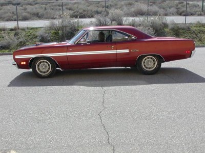

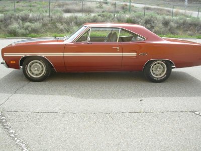

My new MP .96 bars were a large improvement over the stock .92 bars which were also 44 years old. I was able to lower the front a tad and still have a stiffer ride. ( before and after pics.)DSCN3646.jpgP1010083.jpg
