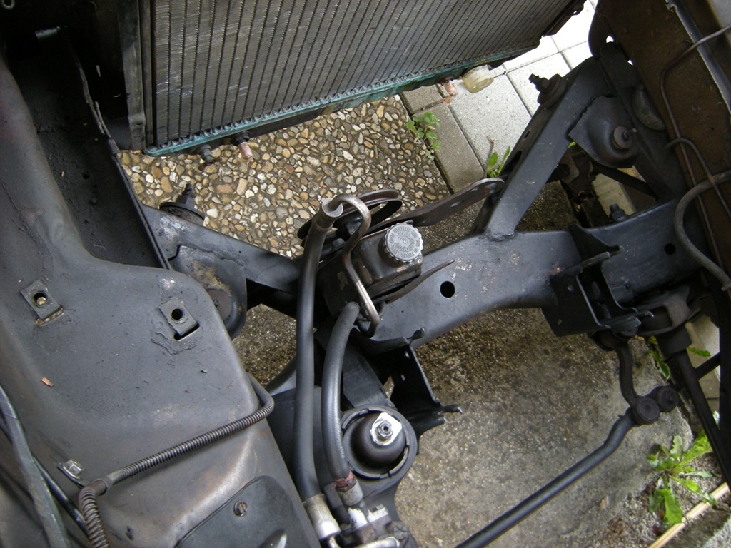

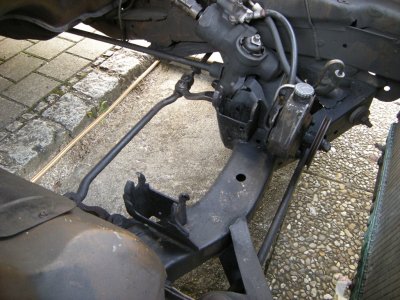

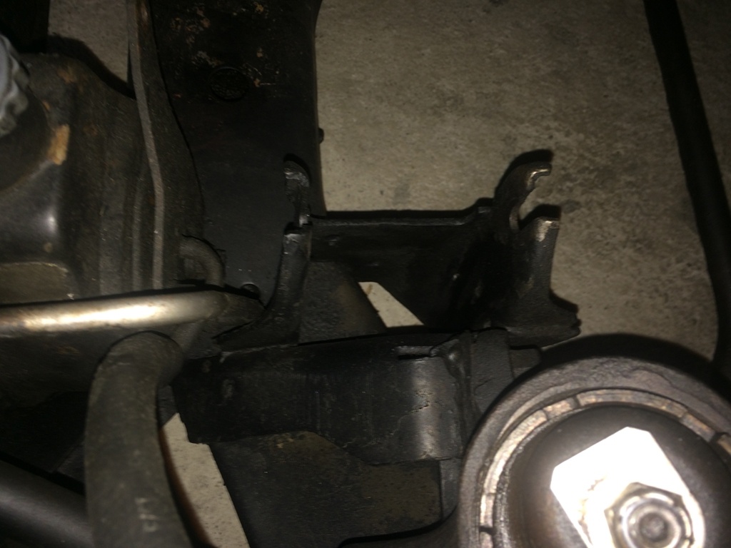

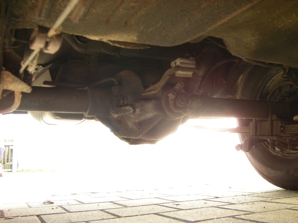

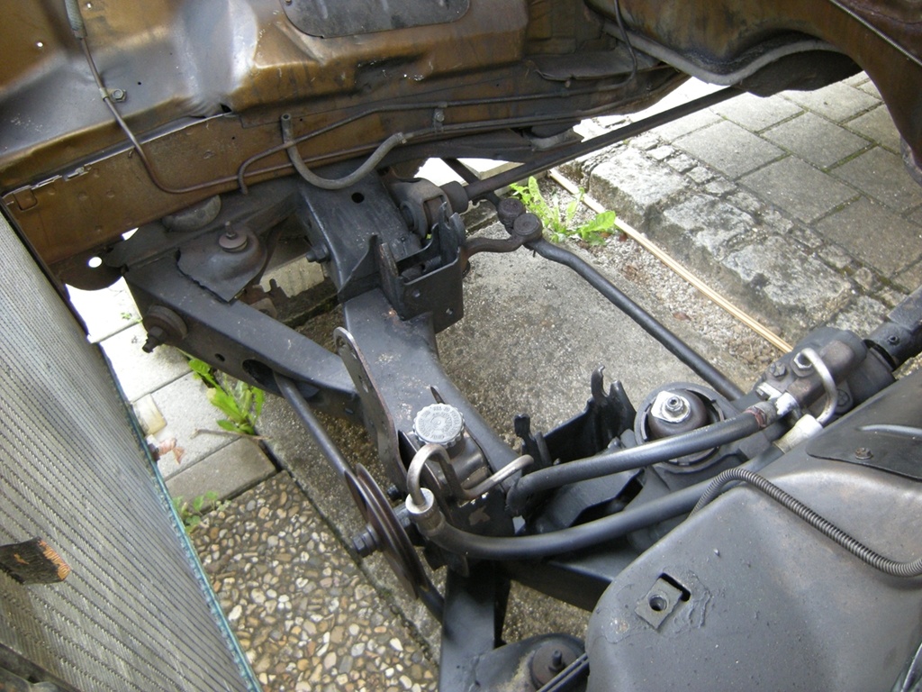

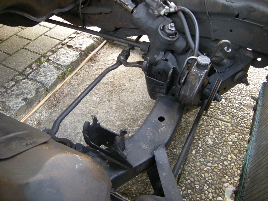

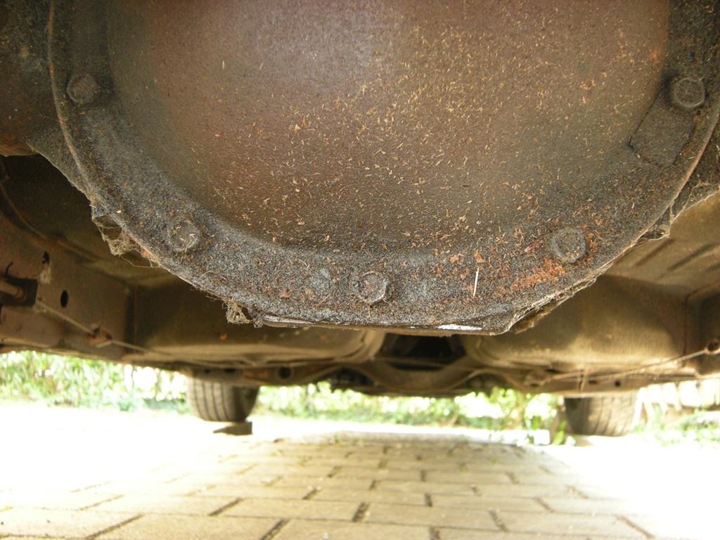

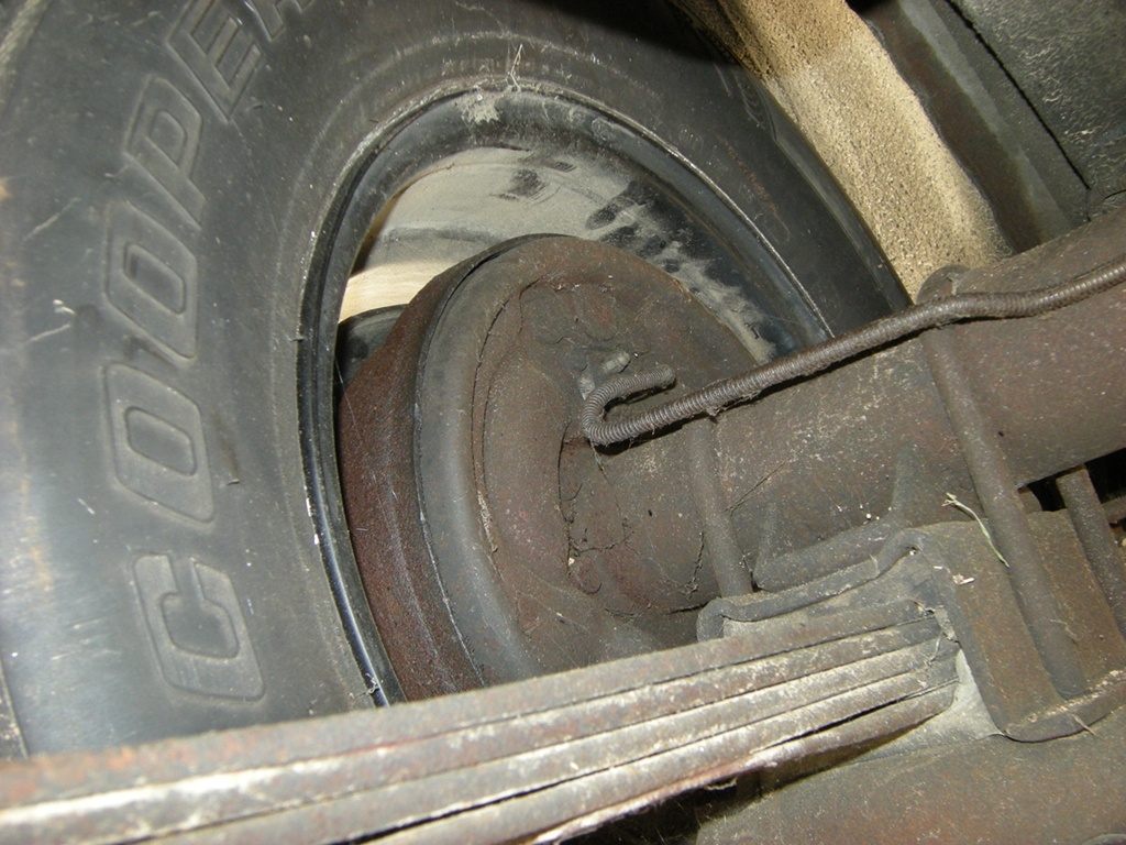

Thanks for your help. That I have to change the transmission is clear. I swapping to a 833 Manual Shifter. It´s only a 23-Spine, but I hope it holds at least some months.... About the rear axle I´m not to sure wich one is exactly in the car. Problem is, that I was spending the last weeks building the engine, and the car itself is in a barn about 60 miles away. So it´s not so easy for me right now to go there and measure every detail immediately. I have some pictures from the rear of the axle and the place where the motor should be placed (I don´t know how this is called in english... we call it "Motorraum", like Space for the Engine)
DSCN3461.JPG DSCN3462.JPG DSCN3464.JPG DSCN3510.JPG DSCN3512.JPG DSCN3513.JPG IMG_9662.JPG IMG_9663.JPG IMG_9671.JPG
You have an 8 1/4 rear axel with the iso rubber mounting for the leaf springs. The 8 1/4 is reasonably stout, Mine has lived in My 74 for over a year with aprox 550hp on street tires with a 727, have a 8 3/4 to going in soon. I made my own motor mounts for my big block swap, but I understand you can purchase them from a "Schumacher"?. There are some threads on this forum about BB swaps.

I'm still small block but have a heavy 73 wagon. Looks like you don't have a front sway bar. There were 2 available for your year from the factory. The larger is the 15/16ths. Firm Feel makes a 1 1/8" and 1/4" that is a bolt in. They also make a 7/8" rear bar but you will have to delete the iso mount system to use it.

You car also uses the spool type motor mounts. They tend to be a lot less problematic compared to the biscuit mounts. You can fill the gaps with silicone and IIRC there are urethane inserts you can press in.
You also have the iso mount rear springs/axle housing. The springs in the rear of the car are going to ride like a sponge. I picked up 2 right side MP XHD springs but cannot comment on ride height or feel yet as they showed up yesterday. I've already done the iso delete so they will be a bolt in for my car, but not yours as it sits without welding a washer onto the spring perch of your existing housing to use the smaller locating pin.

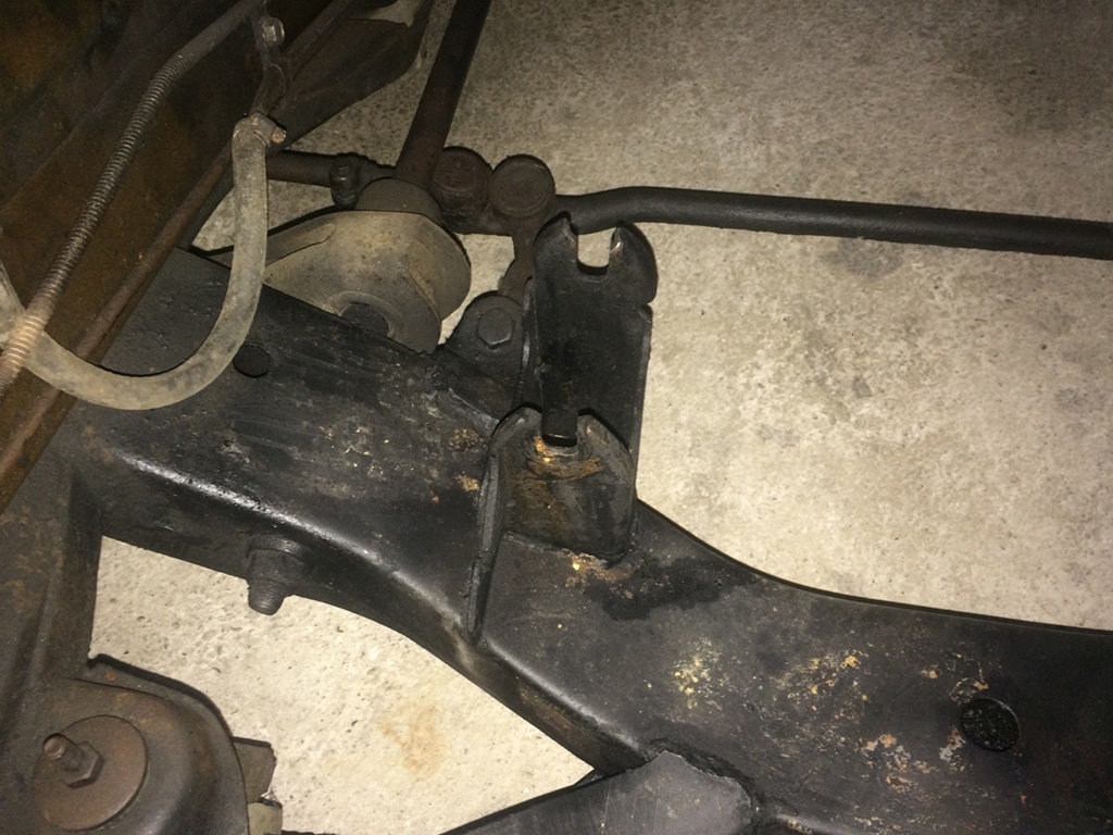

Your picture shows a front sway bar, but the rear requires a relatively hard to find mounting plate on each side. Making your own that will work is probably your best bet. The 71-72 is slightly different from the 73-74 If you do look for these. The Iso mounts are the "isolation" bushings, the rubber inserts around the axles springs. Earlier cars did not have these, hence the difference in sway bar mounting plates.

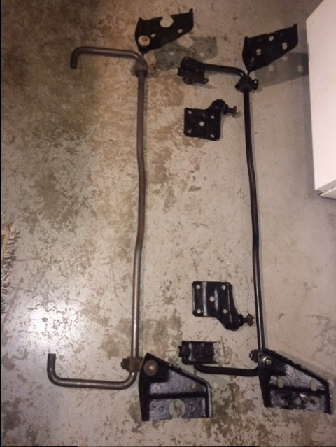

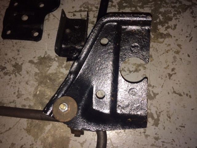

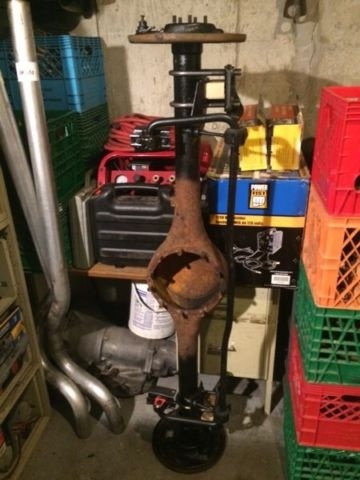

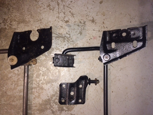

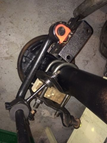

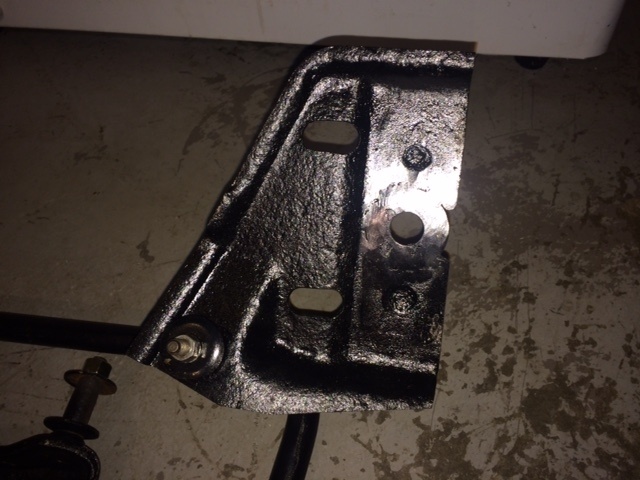

Info for your rear sway bar questions and expanding on the comment about the elimination of the rubber isolation assembly
Here are a pair of 73-74 rear sway bar assemblies I have. One I've modified to eliminate the ISO mounts on the rear axle and use the older style shock plates. I tack welded washers in the large locating hole in the axles spring mounts as well.
