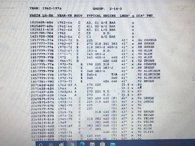

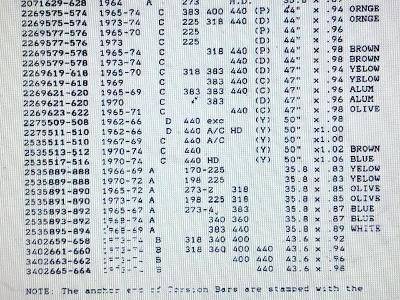

I have been checking and stock torsion bars for a 383 appear to be .88 inch, while bars for a 440/426 are .92. Did they put heavier bars in cars with factory A/C?

It looks like .92s were the largest B body bars. I see no distinction for A/C for any B body model.
Until they got to the 1973-74 B's. Then they jumped up to .92, .94, .96, and .98.
I asked because my 318 A body with A/C got the same bars as the 340's did. It's like they bumped up to the next size due to the extra weight.
