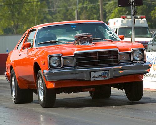

I run my street car which is a supercharged small block F-Body. 10.5wX28,4.30,stock rear springs with 2 extra leaves. Single adjustable QA1 rear shocks. The rest of the suspension is stock including the front shocks. The converter flashes to 5600. This car would hook in a mud puddle. mid 1.5 60 ft, 11.0@122, 3890lbs.

looks like a damn fun/fast "street car" !! {with a 5600rpm converter, do you have 4.88:1 or 5.13:1 gears}

Good looking car. It's great that the car hooks with that power, unfortunately, mine doesn't hook at all , so I need whatever help I can give to it.
