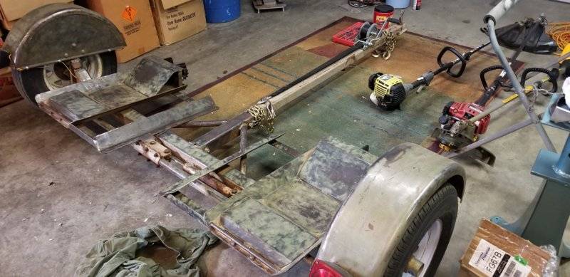

I've towed with one for the better part of 30 years. Kept with it mainly due to storage space restrictions. This year my current dolly is getting upgraded and gone over. The only thing I've found to be a negative over the years is going long distance empty, it will tend to bounce all over on rough roads, so speeds must be reduced to minimize that. The rest as others have discussed apply. Here there's no need for plates. Spare tires for the dolly and your new project should come with you. Mine has a bolt for backing as well. Floor jack, come along or mounted winch as well. I've also tied down a ready to mount rear end with springs to get a 70 charger home. Large cars (like C bodies) require more room on turns or you can get some damage if your dolly has fenders, so care must be taken. It takes more planning and time with a dolly, but to me its part of the fun. If I come across one that needs a trailer, Ill rent one from u-haul, or ask a friend with a 2 place trailer. Happy Hunting.
