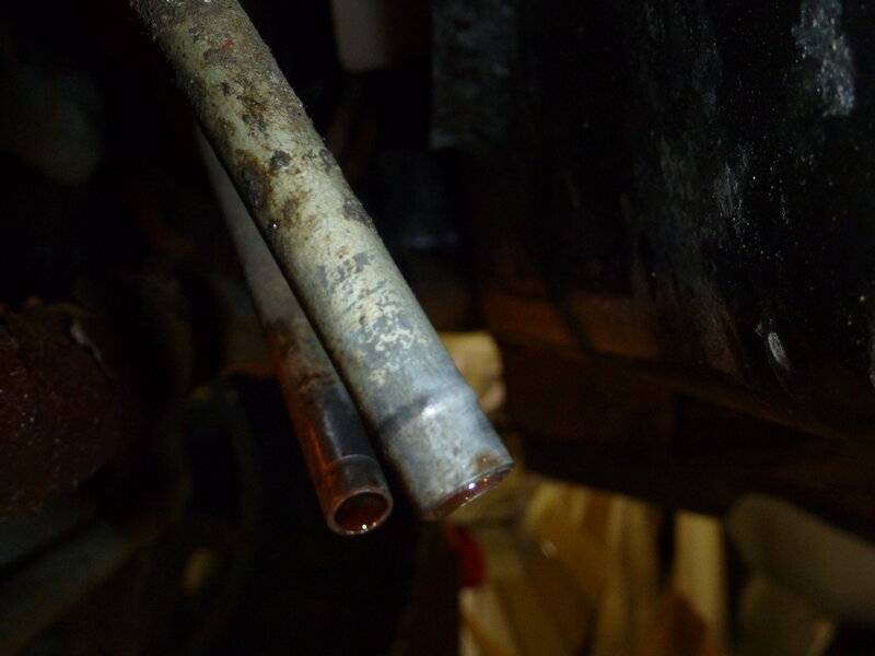

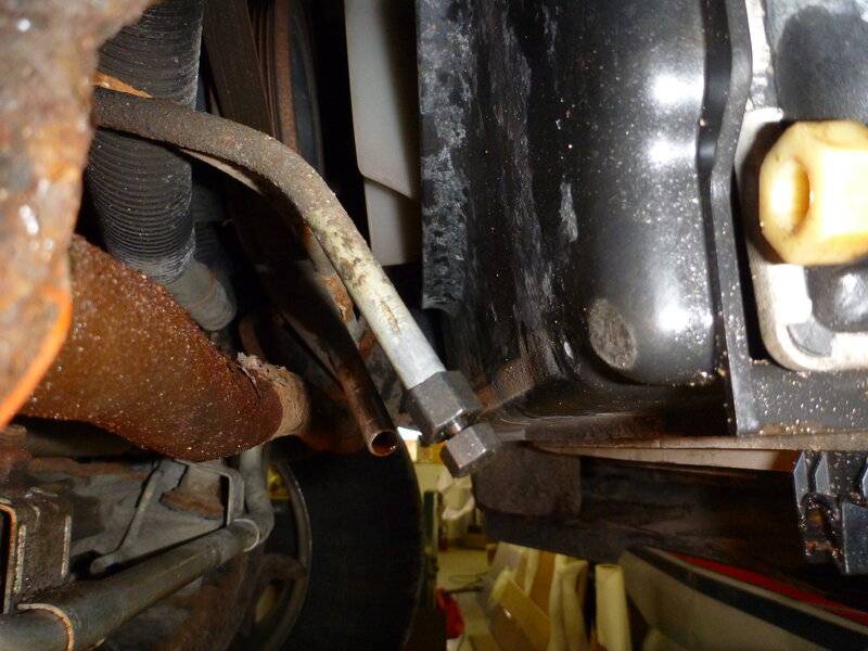

When I tightened my trans cooler line at the radiator the other day I must have moved one of the lines a bit because it ran into the lower pulley and I didn't notice it. I heard a noise but thought it was the water pump - so while distracted by that the pulley ate a hole in the cooler line. What a mess. What PSI flows though the line? Can I cut and splice in fluid rated hose?

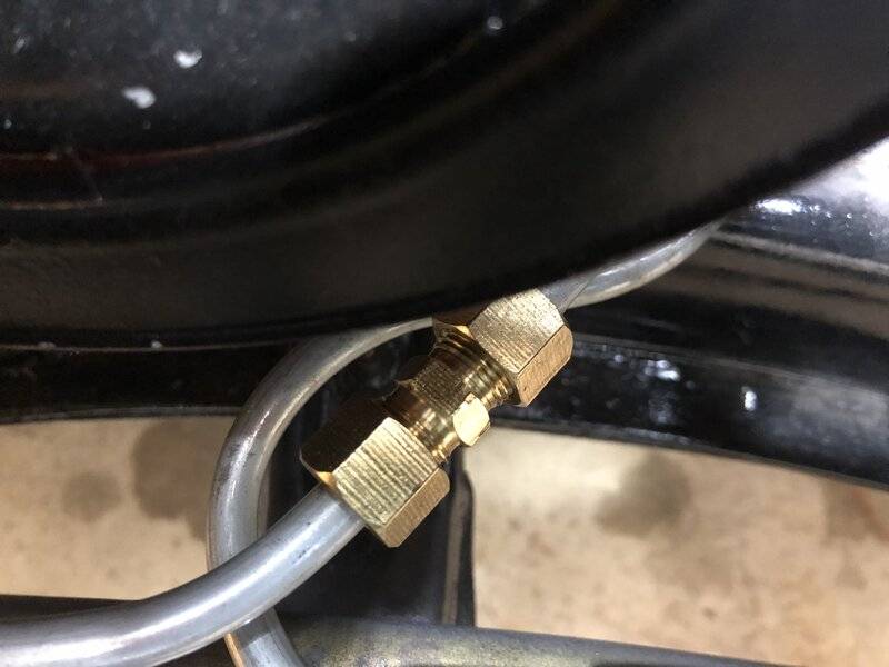

Yes you can use hose, 35 PSI max, but you can just cut the line in two and splice it with a tubing union, compression style. I'm assuming you have a small gash in the tube.

Exactly. Its sliced about 1/2 way through. Any leads on a compression fitting kit? If I can leave it all metal I certainly will. I read the line is 5/16?
If the cut is in a straight area of tubing the compression coupler will work great... Your not the first to have that issue....
Lowes & Home Depot both have to order it... A local auto parts might have it... Twenty years ago they likely would have, today not so much...
Amazon has them but it's a 10 pack... Still cheap enough & you'll have spares (That you'll never need cause you've got them)

A compression fitting would work just fine at that low of pressure. (as you know)

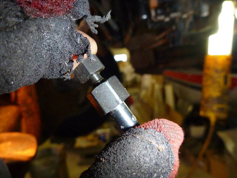

I've never seen that tool. Do you know who makes it? I have always used the first stage of a double flare to make the bulge, which works fine. Steel tubing requires a double flare as single flares often split the tube.
Mike
Pretty sure it came from ATS (Aircraft Tool Supply). It's meant for aluminum tube, but if you slowly bring the ball bearings out it'll put a big enough bead on steel to keep the hoses from blowing off. Just checked, they want stupid money for them now. I paid about 20 bucks each for mine. Also see they don't go smaller than 3/8ths now either.. I have a 1/4", 5/16, 3/8th and a 1/2". https://www.aircraftspruce.ca/catalog/topages/ezbeader.php?clickkey=52413

For now I did the 5/16 compression fitting seems to hold nicely. My lift is currently occupied but I’ll replace the line ASAP
