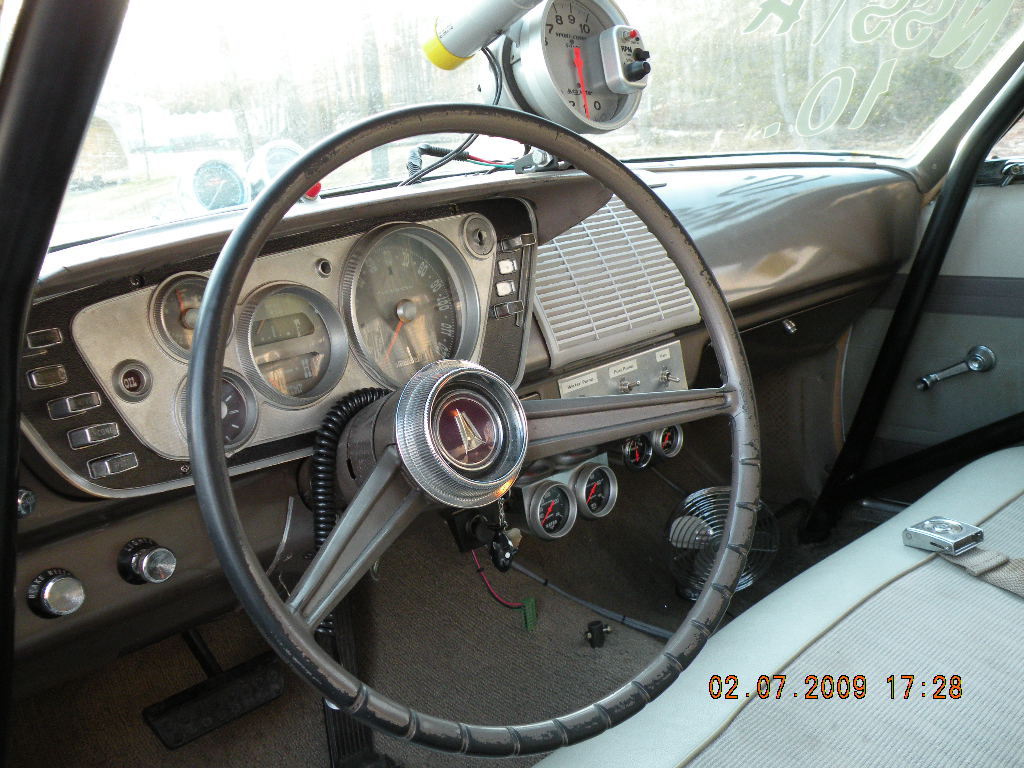

I've been working on these cable shift trans. for many years. The cleanest most effective way to fix a leaking cable is to disconnect it from the shifter box and pull it out and get the correct diameter shrink tubing from Home depot.
Slide the whole piece of shrink tubing to the leaking section, heat it up.Then go to the next size larger shrink tubing and go over that again. Heat it up and reinstall the cable back to the pushbutton box.
It will look just like factory and double leak proof.
