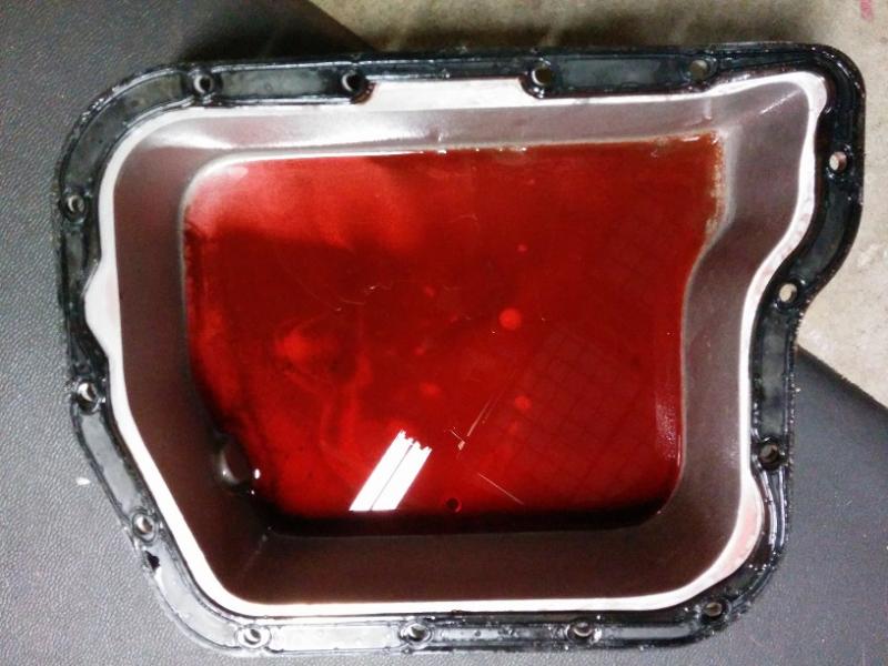

HI Mopar guys,
I have a question about my 727 trans. Right now it will go into reverse but the car will barely move and it will cluck into drive but does not pull very hard. I pulled the pan and this is what it looks like. What you say this is bad? It only had about 1500 miles or less.
Thanks for the help!
Eric

I'm not a trans expert, but the first thing that pops into my head is to check the rear band adjustment.

If it won't move in any forward gears the rear (direct) clutch pack is not be engaged. It is the only element being applied in all forward gears, The forward clutch is functioning as is the low band because reverse functions. Double check fluid level and linkage adjustment. If it worked previously and you haven't messed with the valve body (it is bolted on tight, correct?) then it's my bet it has to come apart for an inspection.

As mentioned the rear clutch needs to engage for any forward gear. If it is the rear clutch the trans needs to come apart to fix it, but check for loss of pressure first. Make sure the rear servo is not cocked in the bore or cracked/broken which would result in pressure loss. Check the filter for clogging (not very likely, the fluid didn't look too bad?) and the valve body for cracks in the internal passages. With the valve body off you can use compressed air to actuate the clutches and bands. You should hear the clutches engage and the servos move with not much air escaping the seals.
Im thinking maybe you have a torq converter that is locked up.

it's full of water or coolant....needs an overhaul and check your radiator.
