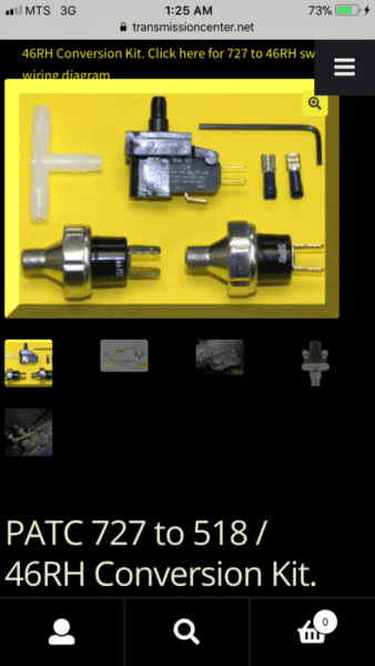

Thanks for the help, I'm running a 360 la motor, and I found pressure switches to control the 46 rh. I'm not going for big power I want reliability and comfort on the highway. My plan in the next few years is to go on a trip to drive all 2442 miles of rt 66 in the car.
