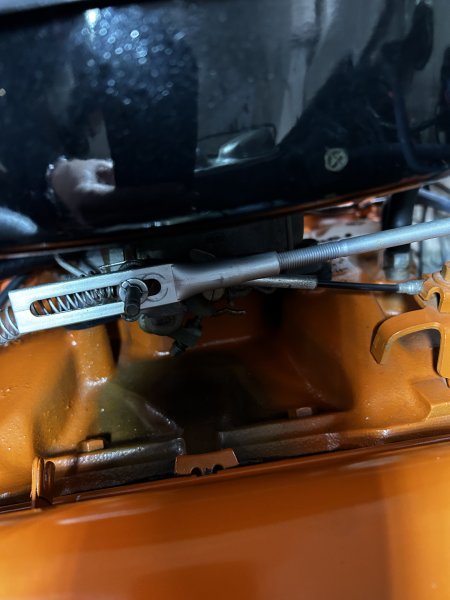

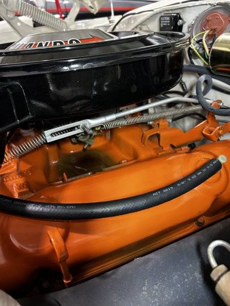

I recently purchased a 1970 Roadrunner. I wasn't able to test drive it before I bought it because of the snow we had. Now that I have it home I'm finding the transmission shifts very hard on light acceleration and extremely hard under hard acceleration. I have done some research on google but it isn't clear to me. looking at the two pictures one with the spring and one with it off, should I be increasing the length?

Said spring does nothing but insure that the throttle pressure linkage returns. Has nothing to do with how it shifts. That said "hard" is good...

Shift kit will do this. The throttle pressure linkage should be all the way back at wide open throttle from the pedal inside the car. Get a helper to floor it.

I will try that tomorrow. Do I have it correct that if I lengthen the linkage the shift is softer and if I shorten it the shift is harder?
In that bell crank where the linkage goes down behind the motor there is a rig pin hole. With a pin (drill bit that fits hole) in the hole the lever on the transmission should be forward against the stop and the slot on the arm against the carb pin. Service manual shows it all.

It's not really kick down linkage. It is throttle valve linkage. It's designed to increase line pressure with the application of throttle. Shortening it will reduce pressure somewhat at a given throttle opening. It'll also make the shifts occur at lower rpm. Better to take a pressure reading. If it's over 100psi with the linkage full back at idle? You may be able to adjust the line pressure back on the valve body with the allen screw. Or as stated it may have a shift kit with a heavier pressure regulator spring installed. You could swap it with a standard spring. I would not adjust the pressure below 95-100 psi with the linkage fully rearward.

Hi Doug, I had some time today to try and adjust the length of the throttle valve linkage. I now see how it affects the shifts. I was able to make it so the shifts are firm but don't hammer the way they did. The 2-3 shift is perfect, the 1-2 a little hard but acceptable. I ordered the transmission pressure gauge kit from Summit and will confirm the pressure is correct. I'm also going to change the filter and fluid as I know fluid type can affect the shifts.
