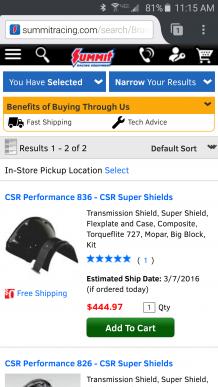

I just put this one on. Im more comfortable with a shield than the blanket that was on the car.

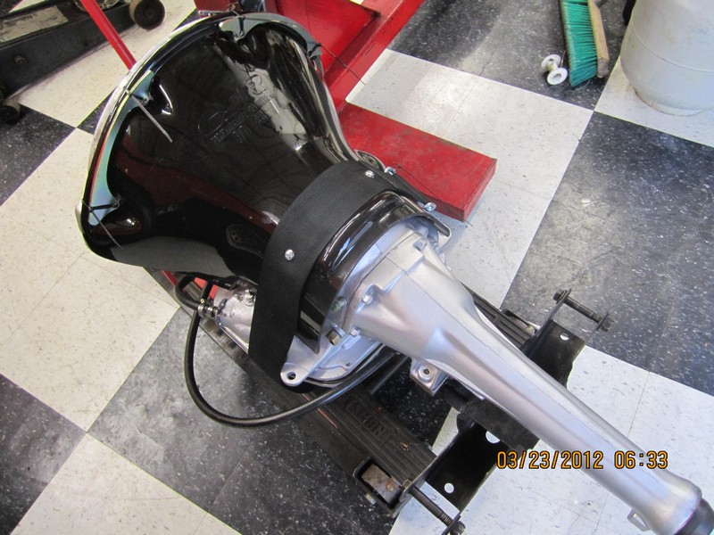

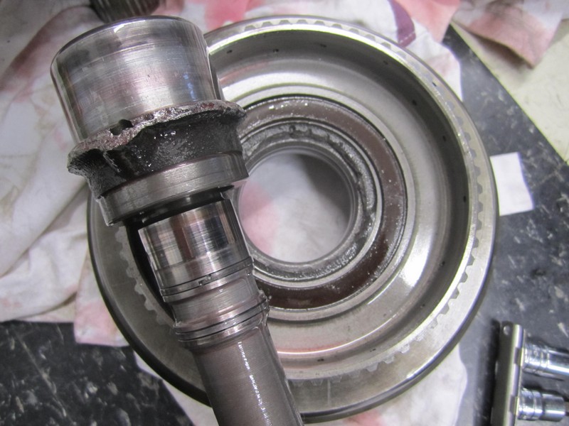

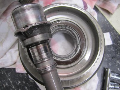

When I started getting nervous about the explosions That were being posted,I bought a CSI shield along with a billet drum and several other trans internals that I broke and upgraded along the way.
So I think the carbon fiber shield is the way to go. Even if you use a blanket,you still need to cover the bellhousing.

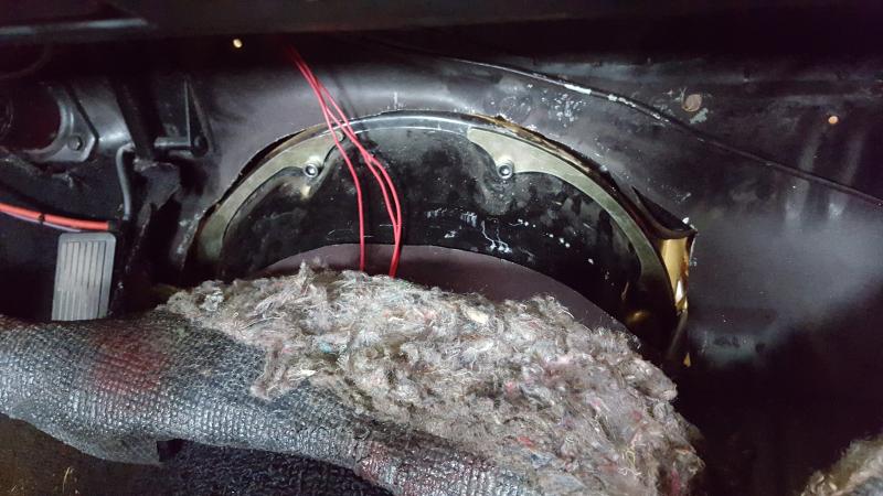

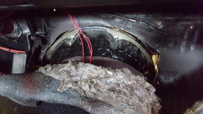

Caution, you may have fitment issues.

I'll let you know how the CSR shield fits in a B Body. I have one for my 71 Charger. I know the seam between the floor pan and firewall has to be removed for it to clear.

Mike I run the CSR shield and strap, same one bobtile posted a picture of. No way to get to top trans bolts after motor and trans are installed. Fit is good!
