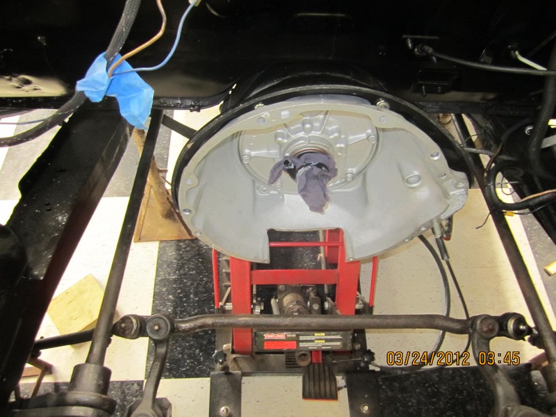

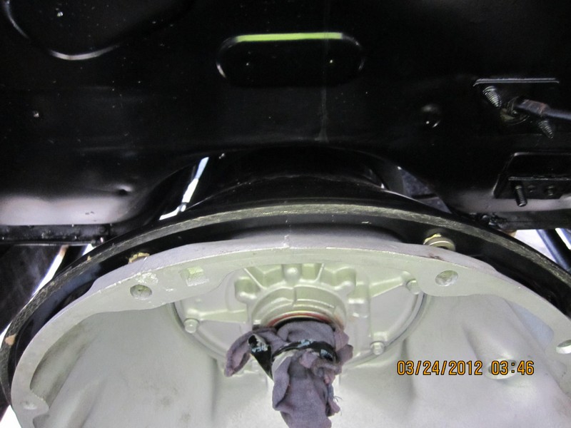

The top 3 bellhousing bolts are PITA.I think I will make holes to get to them with plugs to cover them.

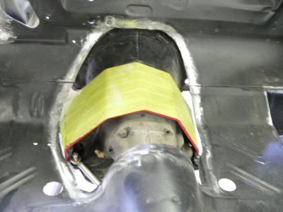

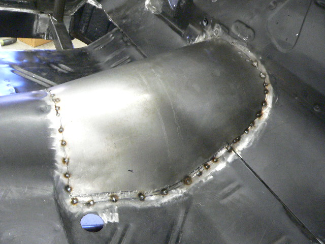

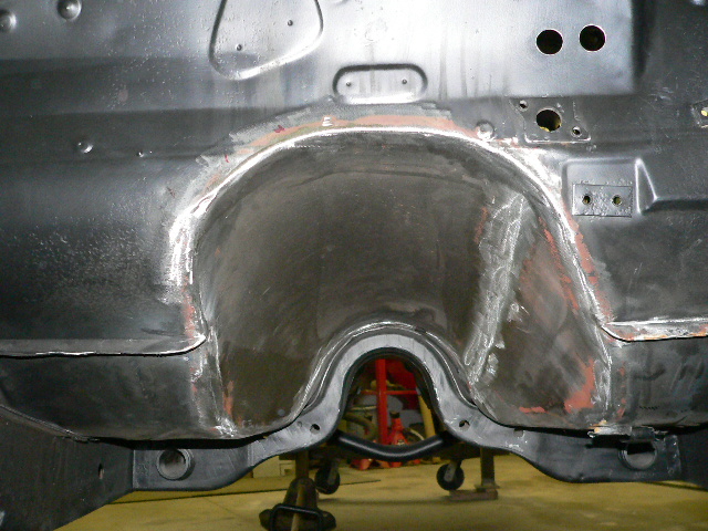

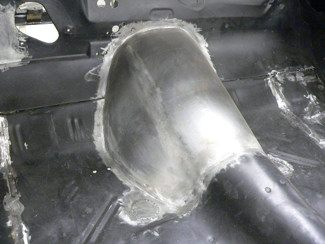

62-65 B-body has a small tunnel. Couple that with the motor being moved back at all. The aluminum shield is a tough fit. You will have the hammer out for more than the flange. Blanket holds heat on the street . My sons cars ran two coolers, still hot. Not mention if you have a leaks it's a wick waiting to light. Blanket installs easy, pull the 4 cross member bolts , tilt the trans down, install the straps at the top two bell housing bolts, jack the trans up, tighten the straps. Been down this trail too many times. Now I always cut the tunnel.
Doug

DVW...Great Job on the tunnel modification !
