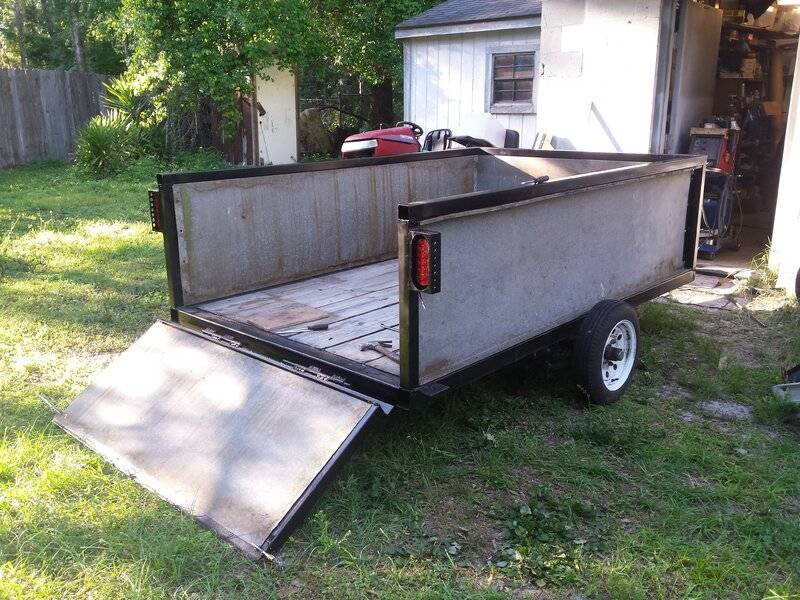

I was thinking of mixing motor oil and mineral spirits so it soaks into the wood for my utility trailer.

I used roll on bed liner on a small utility trailer. So far so good.
