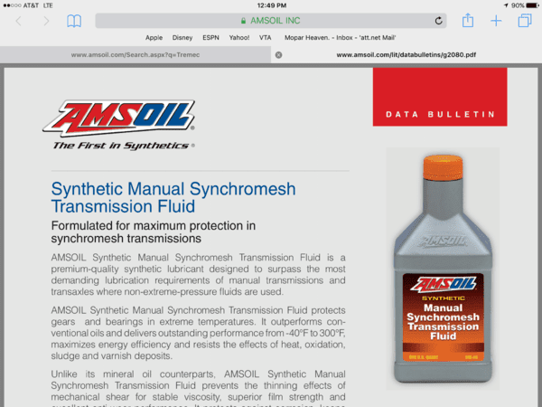

Plan to use the Duralast 7300S seal, and this in. Capacity reported to be just less than 3 quarts.
Fill is on passenger side of trans.

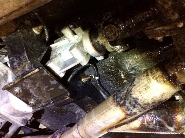

Seal in. This is the rear seal evidence throwing onto the exhaust and driveshaft. Cleaning it up. We will see.
View attachment 550186 Seal in. This is the rear seal evidence throwing onto the exhaust and driveshaft. Cleaning it up. We will see.
Wow, mine wasn't quite that messy. I'm probably not putting as many miles on mine though, haven't made any road trips yet. Hope that seal works better for you. I think I'm still getting a drop or two leaking out every once in awhile now but not enough to actually leak down on the driveshaft and make a mess anymore.

Distantly related, the TKO 5 3550 is a wet mess after the road trip. Leaks everywhere. Gonna replace the rear seal with a Duralast 7300S from Autozone. What fluid weight and capacity?
I think they recommend GM syncromesh for the fluid. I had leapks all over until I realized the loctite red sealer needed the spray primer used on all aluminum surfaces or it will not cure and seal. Ferrous parts like the bolts are no problem.
