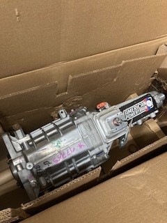

I am about to start the conversion from 727 to a TKO 5 speed. I bought a complete trans, bellhousing, clutch and all the parts from a 68 coronet that was being converted to a modern Hemi swap.
The shifter location out of the floor is quite far forward, i am wondering if anyone in this forum has made a shifter relocation to shorten the throw. Also it would remove the offset bracket between the top of the trans and the shifter.
the photo below is an example of what i am thinking about.

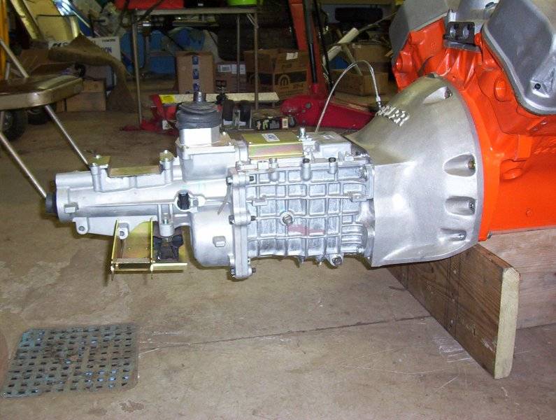

Here is where my tower is located and a picture of it in the car. I have the console and pistol grip. There are many options for shifter towers and shift handles. I would deal with that once I got it in the car with the seat in place.
I think you can move the shifter (you can on the TKX). Also there are a number of aftermarket companies that make different types of shifters that might be helpful.
The pics show where the shifter on my TKX is located. I ordered it that way from American Powertrain, so I have no idea what might be involved in moving the shifter location.

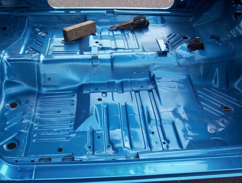

I ended up cutting the crossmember to gain more clearance. I did not have enough room to get my driveline angles correct. I used this upper hoop along with the transmission mount from Holley.
