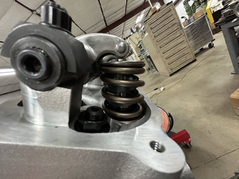

What changes for a hyd roller cam with 440 Source heads (other than hyd roller springs)? You say you would like to stay away from the needle bearing roller rockers. What's wrong with the 440 Source stainless, bushed roller rockers? I think they look great. (And the price is wonderful.) You only have a .500" lift roller cam. Sounds like a good plan to me. Here are pictures of that mocked up.

Thank you Rick, I very much enjoy and learn from you, Joe, and Ed's videos. I own a Vintage BMW motorcycle shop, and specialize in rebuilding those heads, but am ignorant on my Mopar, and really appreciate your input, and gladly will change my direction. I did 31 years in the Army, so "big crayon" answers are great. As far as the add ons, locks $50, retainers $90, springs $184, seals $40, locators $70, brings me to a $434 added cost to heads. I can do my own port, and valve job to correct seating issues. All of this puts me well under what I would have spent. Thank you so much for the help.
