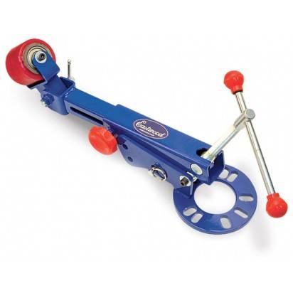

Is rolling it an option? I've done it on a few cars and will always prefer that to cutting if possible.
Yes there are welds, Never rolled one before is there a special tool?
Yeah, Eastwood makes the nicest version I've used...there may be nicer out there as well.
They used to be more expensive. A buddy of mine bought it and he would lend it out as needed. The odd shape of these 66-67 Bodies wheel openings might make it a little tricky, but nothing too crazy.

Back about 10 years ago any tool worth getting was $100+, the eBay deals were around then as well. I'm just surprised to see Eastwood selling for less now. If they were this cheap all those forum pass around loaners would have probably never existed. It is for sure one of those tools you use once and then probably don't even think about for years unless you stub your toe on it.

Jeeze!!! You can get a chinesium one for $38 with a heat gun now! I guess their patent expired...

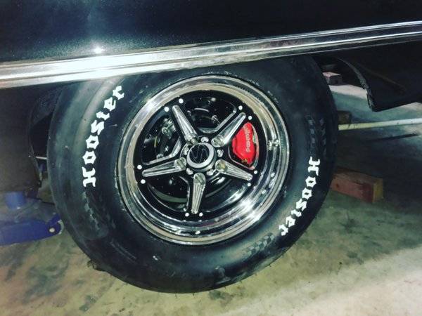

That’s whats on there now 276/60/15 it’s real close.
What backspace are you running on your wheels?
I run 275/60-15 on a 15x8 wheel with 5" of backspace and haven't had any issues after adding a front sway bar. I even ran the car fully loaded down when my Dad and I drove from Chicago to Columbus for Mopar Nationals without a hitch.
