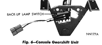

The BU light switch on a '67 console shift car is on the shifter.
